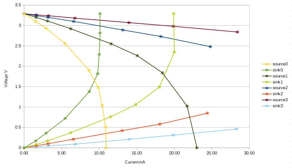

Re: Current Limits
Below shows results of measurement of output voltage v. current for drive strength capabilities 0, 1, 2 and 3 (2 is the default).
The measurements were made with the following resistances: infinite, 2kΩ, 1kΩ, 470Ω, 220Ω, 150Ω, 100Ω, 47Ω and 0Ω. But for strengths 2 and 3 the minimum resistance was 100Ω.
By measuring into a capacitor, I can confirm that the source and sink current limits for drive strength 2 are about 40mA and for drive strength 3 they are about 80mA. Actually source current limits are a little higher than the sink current limits.
The drive capabilities of the digital-to-analogue converters are very different.
