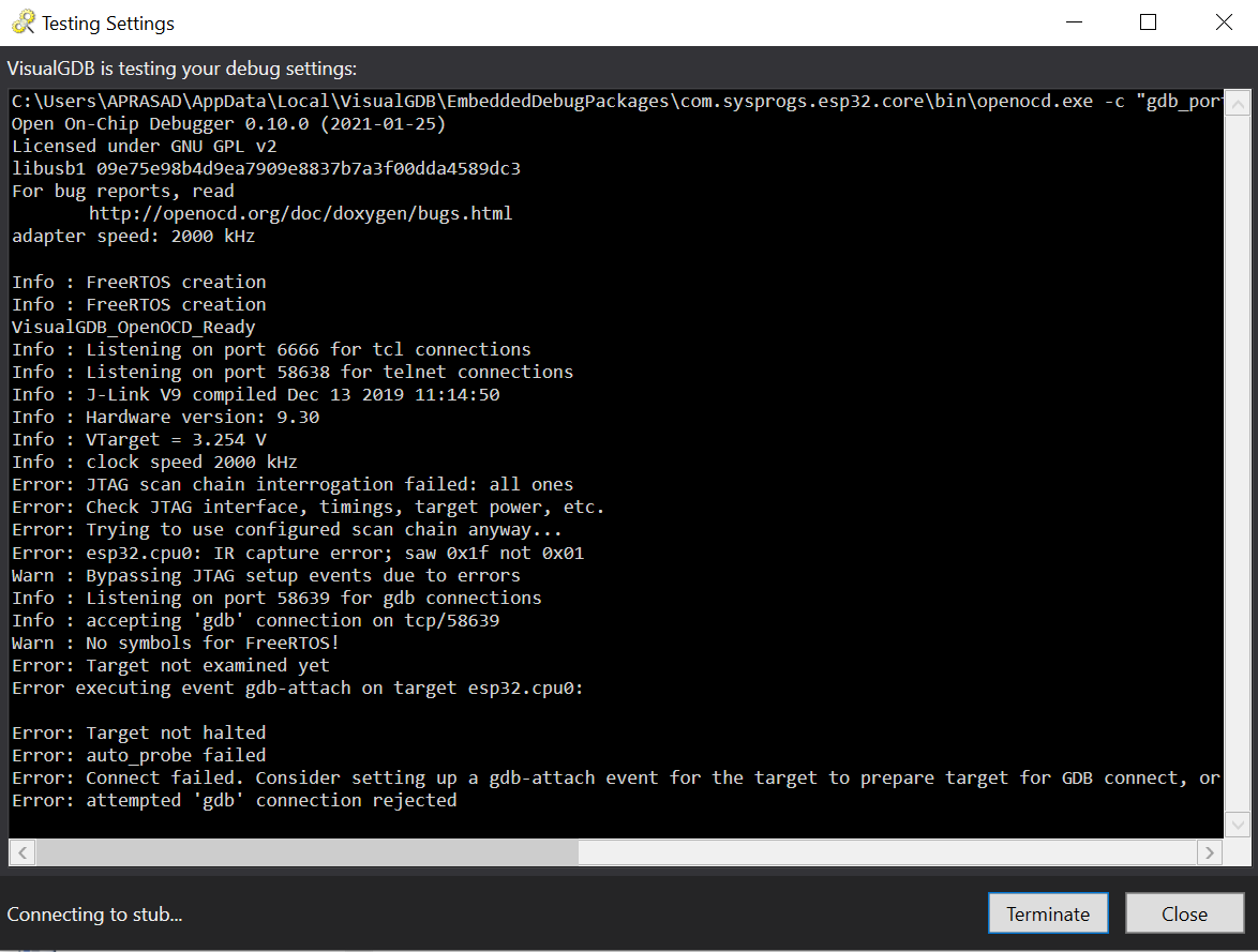

Debug Test Connection Log

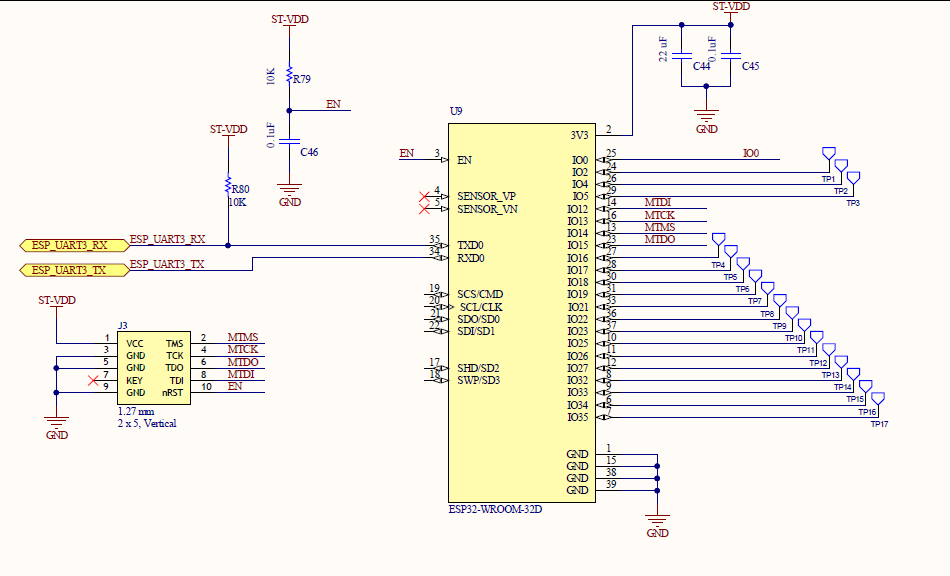

I am sharing my schematic of my custom board which I have took reference from ESP32Devkit C itself.
Please let me know if you find anything.

Posting whole log here :
C:\Users\APRASAD\AppData\Local\VisualGDB\EmbeddedDebugPackages\com.sysprogs.esp32.core\bin\openocd.exe -c "gdb_port 52266" -c "telnet_port 52265" -f interface/jlink.cfg -c "adapter_khz 3000" -f target/esp32.cfg -c "echo VisualGDB_OpenOCD_Ready"
Open On-Chip Debugger 0.10.0 (2021-01-25)
Licensed under GNU GPL v2
libusb1 09e75e98b4d9ea7909e8837b7a3f00dda4589dc3
For bug reports, read
adapter speed: 3000 kHz
Info : FreeRTOS creation
Info : Listening on port 52265 for telnet connections
Info : J-Link V9 compiled Dec 13 2019 11:14:50
Info : Hardware version: 9.30
Info : VTarget = 3.272 V
Info : clock speed 3000 kHz
Error: esp32.cpu0: IR capture error; saw 0x1f not 0x01
Info : Listening on port 52266 for gdb connections
Info : accepting 'gdb' connection on tcp/52266
Error: Target not examined yet
Error executing event gdb-attach on target esp32.cpu0:
Error: Target not halted
Error: auto_probe failed
Error: Connect failed. Consider setting up a gdb-attach event for the target to prepare target for GDB connect, or use 'gdb_memory_map disable'.
Error: attempted 'gdb' connection rejected

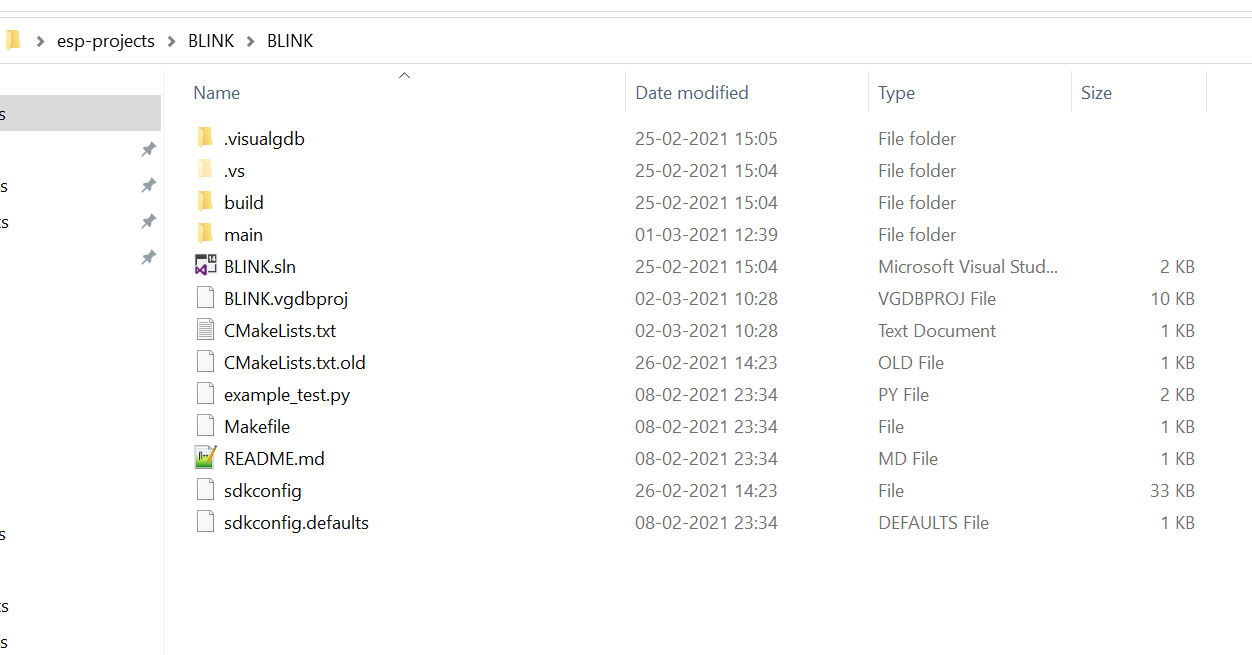

Also attaching my visual studio project folder image.

This error usually means that other firmware on the ESP32 blocks the JTAG pins.
Note that when you buy a fresh board it's usually flashed with AT firmware, which will indeed block the JTAG pins.
You can prevent the AT firmware pin from running by holding IO0 low during reset, after which you should be able to use the JTAG pins.

I was not able reply for a while, I tried to program my custom board serially using FTDI cable while keeping Boot pin grounded and was able to successfully program it. There was a soft AP program preloaded in ESP32.
JTAG debugging was also working fine after programming it serially.
