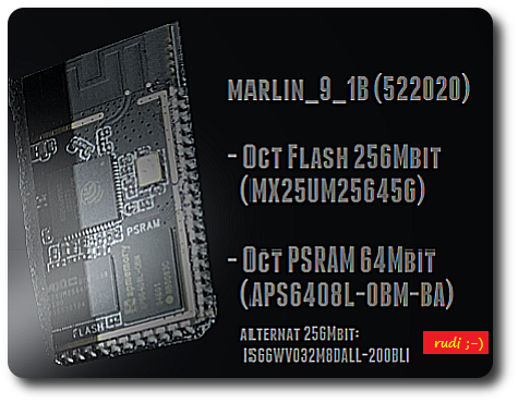

yeap - this modul not using spi octal bus - i have few OPI samples (APMemory, ISSI, .. ) here ( Flash and PSRAM ) in 200 Mbps and 133 Mbps Datarate version ( 1.8V / 3.3 V ) - i think i will use in final design the 1.8V version ( flash and psram ) perhabs 256Mb flash and 256Mb psram in the base, and 1Gb in a test, cause they are fast enough ...
btw:
**easter egg in the IDF**
note 1: MX25UM25645G Octa Flash 8-)
ISSI PSRAM 256Mb ( Mouser: 870-6WVOM38DAL200BLI Manufacturer: IS66WVO32M8DALL-200BLI )
APmemory PSRAM 64Mb further
Preview:
i will update this post on weekend with a "dark pixeld" OPI Version Modul so you can not traceroute the traces on modul :)
but by code - i think now i will be killed by you then if i did this :) let me think over few days how i can do it.
rudi

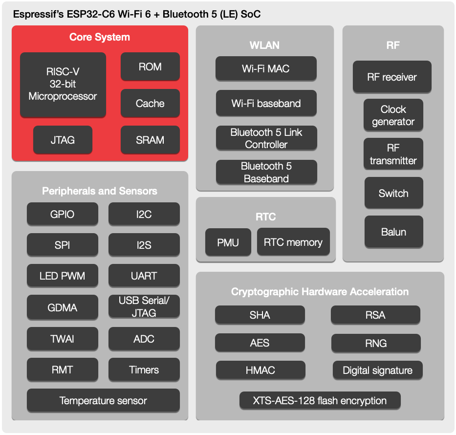

edit 2021-Sept-19 (append ESP32-C6 from Announcing )
ESP32-C6-Announcing
In 1 + 2 there are no questions :)
not only the price for flash/ram is now near doubled last time by problems in few suppliers - it is general happens last weeks with semiconductors - the octal is more usefull as the Q/D version and all is dependent on the usecase's also dependent on the need- if ones need octal flash/ram it needs more power too sure, the new octal series 1.8V ( 200 ) are not bad in the current consumption, there are few things also from winbond with 1.2V - which was talked here in the BBS in past too.

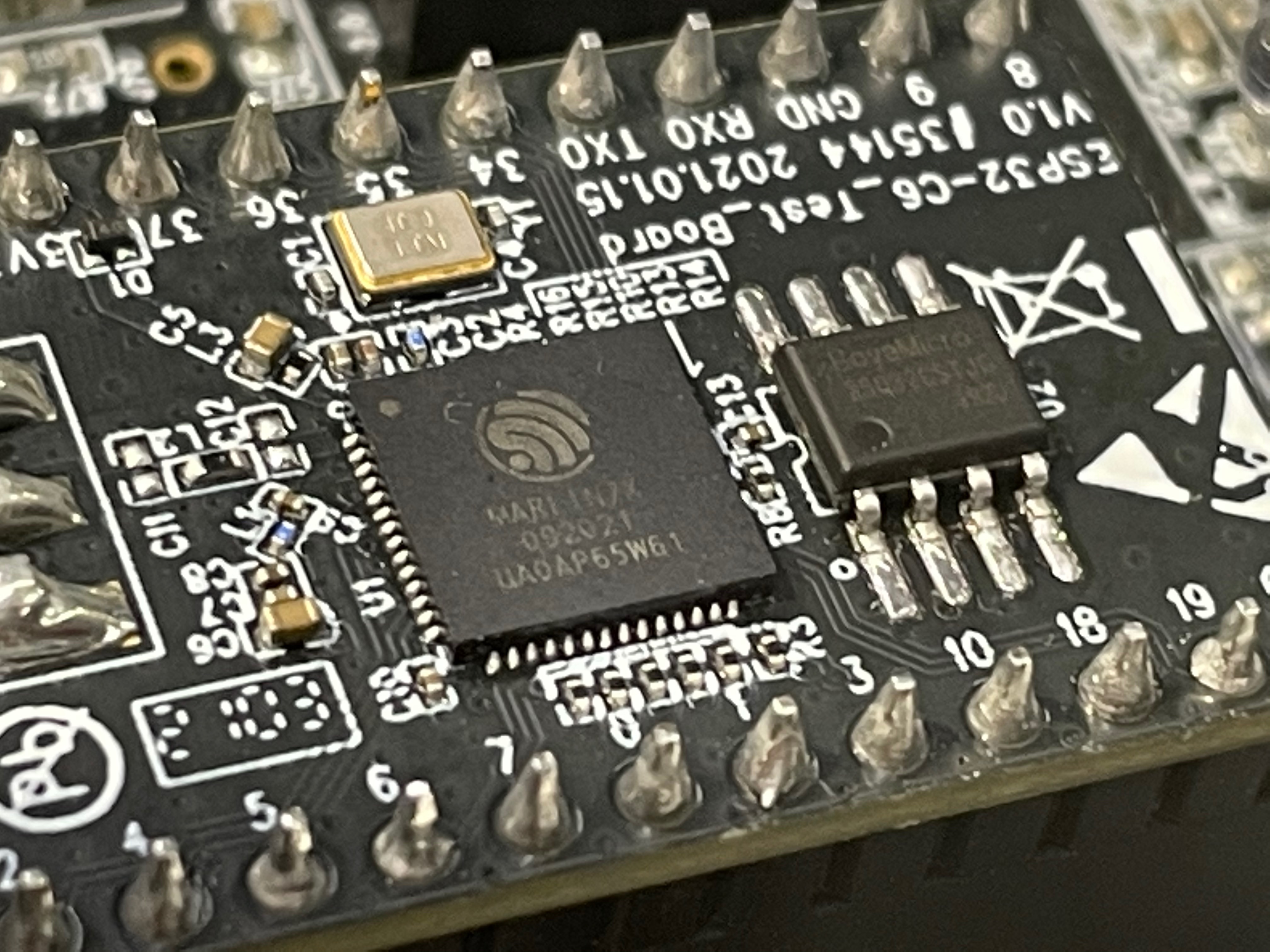

also have a note to this company BOYAMICRO. They have the 256M ( or here ) also the 512 as SOIC-8 and they named it with 5µA in the 32'ish Datasheet and use dtr. BY25Q32* it is used with the ESP32-C6 in the Testboard. BY delivery also KGD for SiP / MCP.
btw:
the mentioned Marketing case is mean to the NEW ESP32-C6_Test_Board V1.0 with SMA Conn. (PIC attached, SMA cutted ) likewise the ESP8266 launcher has - C6 was spotted in the wild last hour's ... there is no "C6" in the ESP-IDF ./.not have been discovered.. yet
ups.. C6 is named here now too :mrgreen:
( new thread is need )
ESP32-C6
