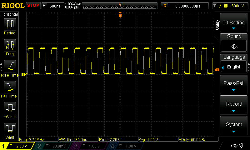

Can I know what's the Max ESP32 PWM frequency?
Need to drive 2.7MHz Piezoelectric transducer.

If you're not going to use for motor control, I recommend you to try the LED Control.
You can try this code to test.
#include <stdio.h>
#include "driver/ledc.h"
#include "esp_err.h"
#define LEDC_OUTPUT_IO      15 // Output GPIO of a sample 1 Hz pulse generator
static void ledc_init(void)
    // Prepare and then apply the LEDC PWM timer configuration
    ledc_timer_config_t ledc_timer;
    ledc_timer.speed_mode       = LEDC_HIGH_SPEED_MODE;
    ledc_timer.timer_num        = LEDC_TIMER_1;
    ledc_timer.duty_resolution  = LEDC_TIMER_4_BIT;
    ledc_timer.freq_hz          = 2700000;  // set output frequency at 2.7 MHz
    ledc_timer.clk_cfg = LEDC_APB_CLK;
    ledc_timer_config(&ledc_timer);
    // Prepare and then apply the LEDC PWM channel configuration
    ledc_channel_config_t ledc_channel;
    ledc_channel.speed_mode = LEDC_HIGH_SPEED_MODE;
    ledc_channel.channel    = LEDC_CHANNEL_1;
    ledc_channel.timer_sel  = LEDC_TIMER_1;
    ledc_channel.intr_type  = LEDC_INTR_DISABLE;
    ledc_channel.gpio_num   = LEDC_OUTPUT_IO;
    ledc_channel.duty       = 8; // set duty at about 50%
    ledc_channel.hpoint     = 0;
    ledc_channel_config(&ledc_channel);

For Arduino, you can try this one:
#define LEDC_CHANNEL_0     0
// use 4 bit precission for LEDC timer
#define LEDC_TIMER_4_BIT  4
// use 2.7MHz Hz as a LEDC base frequency
#define LEDC_BASE_FREQ     2700000
#define LED_PIN            5
void setup() {
  // Setup timer and attach timer to a led pin
  ledcSetup(LEDC_CHANNEL_0, LEDC_BASE_FREQ, LEDC_TIMER_4_BIT);
  ledcAttachPin(LED_PIN, LEDC_CHANNEL_0);
  ledcWrite(LEDC_CHANNEL_0, 7);
void loop() {
