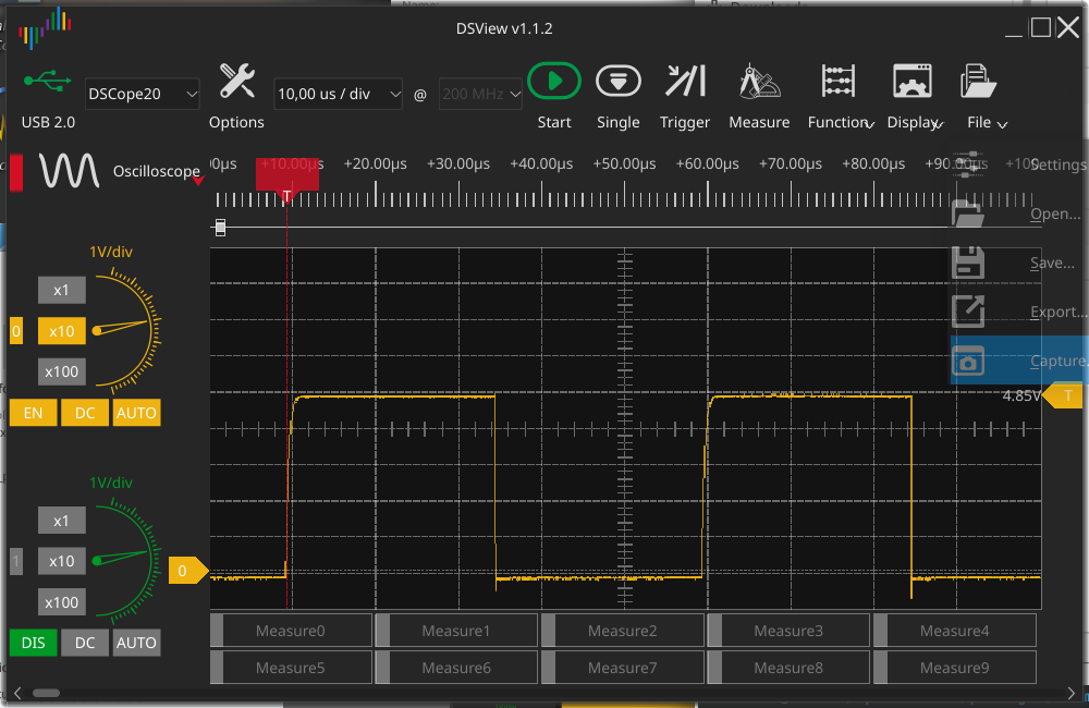

Postby ritsch@algo.mur.at » Wed Mar 31, 2021 3:51 pm
Thank you very much for the advice.
With the `pinMode(...)` I already did this on en ESP32 quite a time now (a year).
... the ESD protection will limit your GPIO voltage to a bit above 3.3V ...
I could measure 4,85V with my oscilloscope, see snapshot:
- Rpu=10 kOhm on GPIO33 on an ESP32S2 (Olimex board):
PWM pulse Open drain to 5V
Did I ruin the ESD protection ?

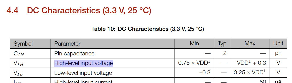

Posts: 10652
Re: LEDC with open drain outputs
Postby Sprite » Thu Apr 01, 2021 1:35 am
It's under 'DC characteristics':
ritsch@algo.mur.at

Postby ritsch@algo.mur.at » Thu Apr 01, 2021 8:35 am
Thank you for the hint, now I understand:
The output is always still an input, so we have to use the "input characteristics" for outputs
and therefore there are no output characteristics in the data sheets, which are superseded by them.
open drain is implemented to realize buses with common pull ups not for voltage level jumps, like I am used with ancient uCs.
Using VDD3P3_CPU in my case causes
- max voltage level: with VDD3P3_CPU=3.3V is V_IH=3.6V
- min voltage level: V_IL= -0.3V
ESD circuit with diodes are responsible for the +/-0.3V borders and VDD is default VDD3P3_CPU.
Power supply for GPIO33, GPIO34, GPIO35, GPIO36 and GPIO37 is configurable to be either VDD3P3_CPU (default) or VDD_SPI.
Not allowing to change gpio direction with gpio_set_direction(...) is intended to prevent wrong applications,
but can be done directly in registers like the Arduino-framework does.
Is this correct ?
thanks for information

Postby Sprite » Fri Apr 02, 2021 3:06 am
That's one way of looking at it. The other way is that 'open drain' mode effectively switches the pin between output-low and input-only mode. (The other side of the coin is that the datasheet is a bit misleading at this point, as connecting 5V to an input also won't lead to anything good. We should duplicate or move those specs to the 'absolute maximum' table, I'd think.)
In the case of the ESP32, open drain is mostly implemented to be able to do wired-AND (what you call 'buses with common pull ups') like I2C. Some microcontrollers (mostly 'ancient' ones, indeed) lack ESD protection on some pins, allowing them to handle higher voltages as well. The ESP32 is not one of those.
This is correct.
I'm actually not sure why this difference is. The ESP-IDF implementation seems more simpler and the Arduino one a bit more complicated; perhaps the Arduino code has some side effect that makes this work.
