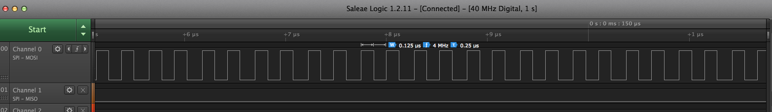

Hi guys :)
I recently got my ESP32 (it's Rev0, I already checked that) and it runs fine, except that I don't get why the maximum toggle frequency for GPIOs seems to be 4 MHz.
w1ts w1tc 4mhz.png (34.2 KiB) Viewed 112913 times
Is this really the maximum (the peripheral bus clock rate is 80MHz, so shouldn't it be 40MHz?)? Or are now the slow register-adresses (as mentioned in the ECO pdf) standard?
Im running the latest IDF (from github) and my project is based on the esp-idf-template (again form github).
My Toggle-function runs on Core1 (as a thread pinned to it).
I use GPIO.out_w1ts and GPIO.w1tc to set/clear the GPIO.
I have tried to simplify the code code as far as possible eliminate any "codelogic-errors".
The critical code section:
void toggle(void *pvParameter) {
	printf("toggle called.\n");
	portDISABLE_INTERRUPTS();
	while (1) {
		GPIO.out_w1ts |= (1 << GPIO_NUM_23);
		__asm__ __volatile__("nop;nop;nop;nop;nop;nop;nop;"); // Bug workaround (I found this snippet somewhere in this forum)
		GPIO.out_w1tc |= (1 << GPIO_NUM_23);
	// GPIO.out doesn't make any difference
	portENABLE_INTERRUPTS();
My complete main.c file: https://pastebin.com/9eYRUMVs , maybe you can check for errors :)
So why do I want to Toggle a GPIO as fast as possible? Why not...
I'm trying to get data as fast as possible into 4 x 8 D-FlipFlops (4 x 74ahct574), so I have 8 data lines and 4 clock lines.
Im new to ESP32 so I don't exactly know yet, how some of the peripherals/DMA work, so I thought this would be a good start
I am thankful for any help and maybe you can point me in the right direction to solve my problem.
PS: I'm sorry for any spelling/grammar errors, I'm not a native speaker.

Postby Hans Dorn » Wed Apr 05, 2017 1:25 am
Hi Alizame,
as far as I understand the w1ts/w1tc registers, you don't have to read them out to set/reset GPIO bits.
Try this version:
   while (1) {
      GPIO.out_w1ts = (1 << GPIO_NUM_23);
      GPIO.out_w1tc = (1 << GPIO_NUM_23);

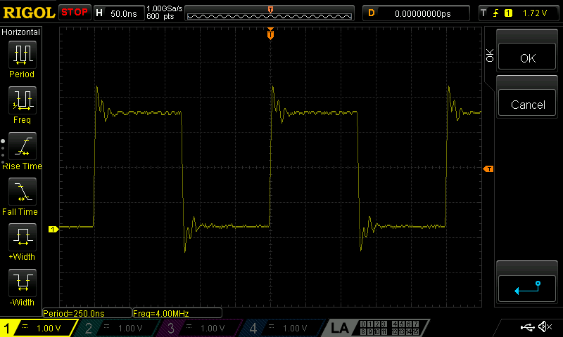

Tried it with a logical analyzer same result. Very slow. STM32f4 is 100MHZ.

Posts: 2344
Re: ESP32 - GPIO speed lower than expected
Postby Angus » Wed Apr 05, 2017 4:31 am
For pin twiddling, you can get to 10MHz if you remove the "bug workaround":
while (1) {
    GPIO.out_w1ts = (1 << TogglePin);
    GPIO.out_w1tc = (1 << TogglePin);
(No workaround is necessary here, the R0 silicon bug only triggers if you write to the same register multiple times in a row, but this code is writing two registers - OUT_W1TS & OUT_W1TC - alternately.)
A quick peek at the generated assembly shows that's pretty close to optimal:
xtensa-esp32-elf-objdump -S build/app-template.elf
        while (1) {
400f1d10:       7a0d81          l32r    a8, 400d0544 <_flash_cache_start+0x52c>
400f1d13:       7a0d91          l32r    a9, 400d0548 <_flash_cache_start+0x530>
400f1d16:       0020c0          memw
400f1d19:       2899            s32i.n  a9, a8, 8
400f1d1b:       0020c0          memw
400f1d1e:       3899            s32i.n  a9, a8, 12
400f1d20:       fffb06          j       400f1d10 <app_main+0x1c>
If you compile in Release mode then the extra compiler optimisation moves the jump target so it doesn't reload a8 & a9 each time around the loop, which doesn't actually change the result (due to CPU pipeline, buffered writes, slower I/O bus).
If you rewrite in inline assembler then you can even take out the memory barrier "memw" instructions for absolute minimum code size, but this also doesn't change the result - the CPU waits for the previous write to each register to complete before it writes there again.
We realise that 10MHz is not terribly fast, however using a fast CPU to bit-bang values is also much more fiddly than bit-banging on a simple 8-bit microcontroller. ESP32 has peripherals which help with this:
  • The RMT Peripheral is nominally designed to send/receive IR remote control signals, but can send/receive arbitrary pulse sequences. For example here is a project that uses it to drive addressable LED strings.
  • The SPI buses all function in DMA mode when using the IDF included driver, so you can clock data in/out at up to 80MHz.
  • The I2S peripheral can be used in a parallel mode to drive a single clock and multiple data inputs/output pins, also via DMA. I don't think a general-purpose driver is available for this yet. Ivan's camera example shows how to do it for clocking parallel data in, I'm not sure if a similar example exists for parallel data output yet.
If you can offload the bit-twiddling work to the peripherals, then CPU can spend its time handling WiFi, Bluetooth, high-level logic, etc.

As you can see the "loop called" from the loop function never gets printed out and the Watchdog starves ;(
I hope you can help me again ;)
Angus
Posts: 2344
Postby Angus » Thu Apr 06, 2017 12:16 am
If I write to GPIO.out_w1ts directly (like "GPIO.out_w1ts = (1 << 23);" ), my Core0 crashes or something like that (TG1WDT_SYS_RESET happens and Core0 doesn't print that it got to my loop function, but the GPIO gets set correctly until the ESP resets).
If I write it like "GPIO.out_w1ts |= (1 << 23), everything works fine (but slower). Also GPIO.out_w1tc works perfectly as expected.
I think this is probably something to do with the fact that the task is permanently disabling interrupts. When I was playing with that code it also regularly reset itself.
If you disable interrupts in chunks, and come up for a breather now and then (just re-enabling them and immediately disabling them should be enough) then it should be OK.

I was able to get 10Mhz @ESP32 working at 240Mhz with following instructions:
You can save on bit shifting the bit 1<<(2)
GPIO.out_w1ts = 0x04; // GPIO2 HIGH
GPIO.out_w1tc = 0x04; // GPIO2 LOW
My code was compiled still in debug mode.
Not sure, if there is a way to increase the speed a bit more?
