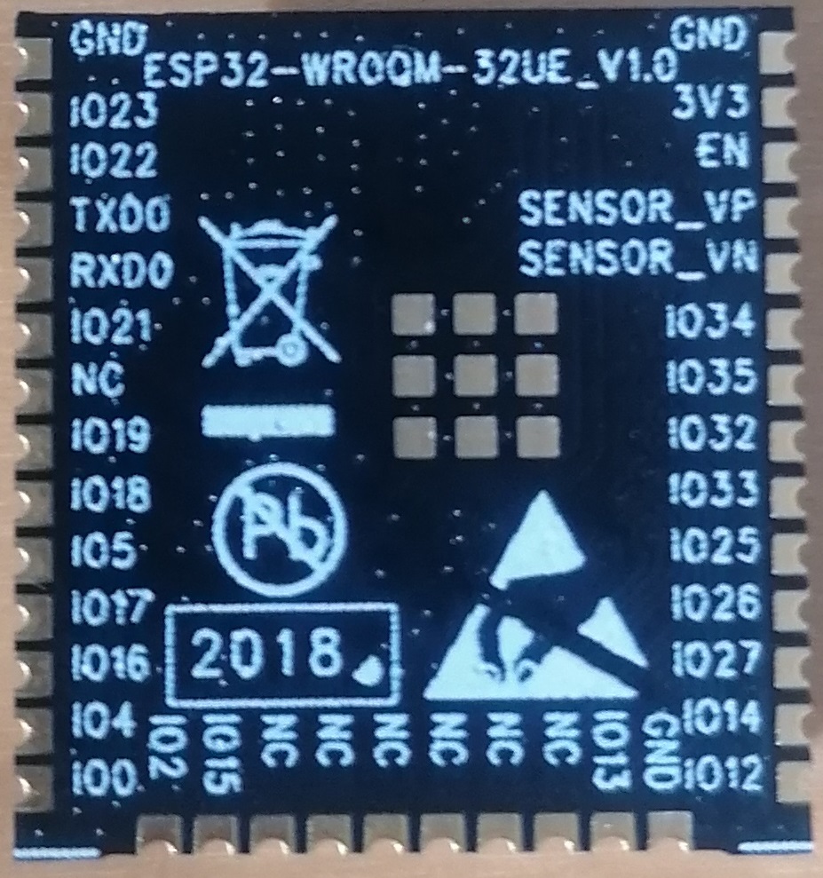

Hello everyone,
I am creating a custom PCB with ESP32-WROOM-32UE module which has EPAD divided into 9 copper areas. Footprint should look exactly the same? Should one larger area of copper be used and solder paste applied only at 9 points ?
Thank you in advance

Our datasheet has a recommended land pattern (figure 10, page 28). Suggest you follow that.
