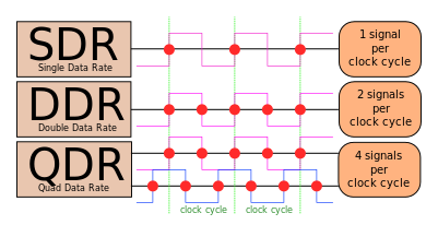

Hi @rudi,
Have you heard of QDR(Quad Data Rate) memory ?
From what i researched i only found with parallel address and parallel data and are very expensive(high performance too), with write and read independent interface for write and read at same time.
A "octal spi" with QDR would be very nice.
OR a quad spi(SQI) with QDR would be very nice too.
QDR use two clock signals with 90 degrees out of phase.

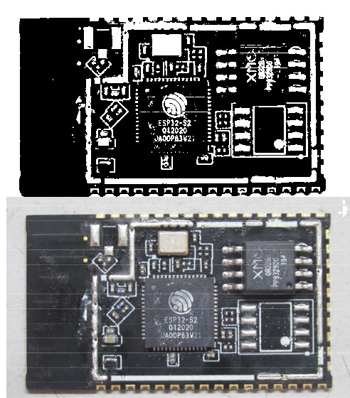

BTW-FYI: Do you know the ESP32-s2 WROOM?
( FCC: 2AC7Z-ESP32S2WROOM )
it has usually ESP32-S2 and the Flash. But no PSRAM and no PSRAM inside die.
If you look into ( under the case ) you see an empty (comfortable) place for the PSRAM ( or an second flash like you want use ur code with the modul )

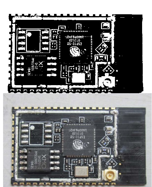

it comes also as an IPX version

Hi @rudi,
yes, example
