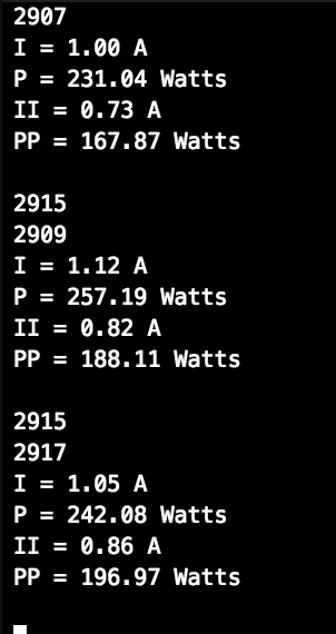

I have work around ACS712 with ESP32
ACS712 on ESP32
Screen Shot 2560-03-31 at 23.43.48.png (34.76 KiB) Viewed 29886 times
This pic is showing value of power load current but i still doesn't turn on anything

I would like to know why esp32 isn't show correct value? and how to get data ACS712 with ESP32

You read 2900 which is near 2.5v. You should use voltage divider to halve output of acs712, keep in linear region of ADC, then calibrate and convert.

I suposed yhat you are using ACS712-30A for measurement of low currents ( 66mV / A) . It´s not recommended !
This sensor don't has good linearity . Other types of ACS712 has not good linearity, too.
ESP32 support only 1,0V at ADC Input. Then you must do a voltage divider.
