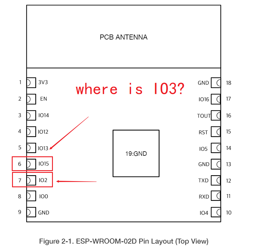

Postby icyrockton » Sat May 01, 2021 4:34 pm
I've read the ESP-WROOM-02D data sheet [url]extension://cdonnmffkdaoajfknoeeecmchibpmkmg/assets/pdf/web/viewer.html?file=https%3A%2F%2Fwww.espressif.com%2Fsites%2Fdefault%2Ffiles%2Fdocumentation%2Fesp-wroom-02u_esp-wroom-02d_datasheet_en.pdf[/url] .
In page 10 . I found i2s interface description .
IO15 (I2SO_BCK );
IO3 (I2SO_DATA);
IO2 (I2SO_WS )
but I can not find IO3 pin ? so, where is IO3?

Postby krzychb » Sun May 02, 2021 10:28 am
Hi icyrockton,
IO3 is labeled as RXD pin, please see Table 2-1. ESP-WROOM-02U/ESP-WROOM-02D Pin Definitions
