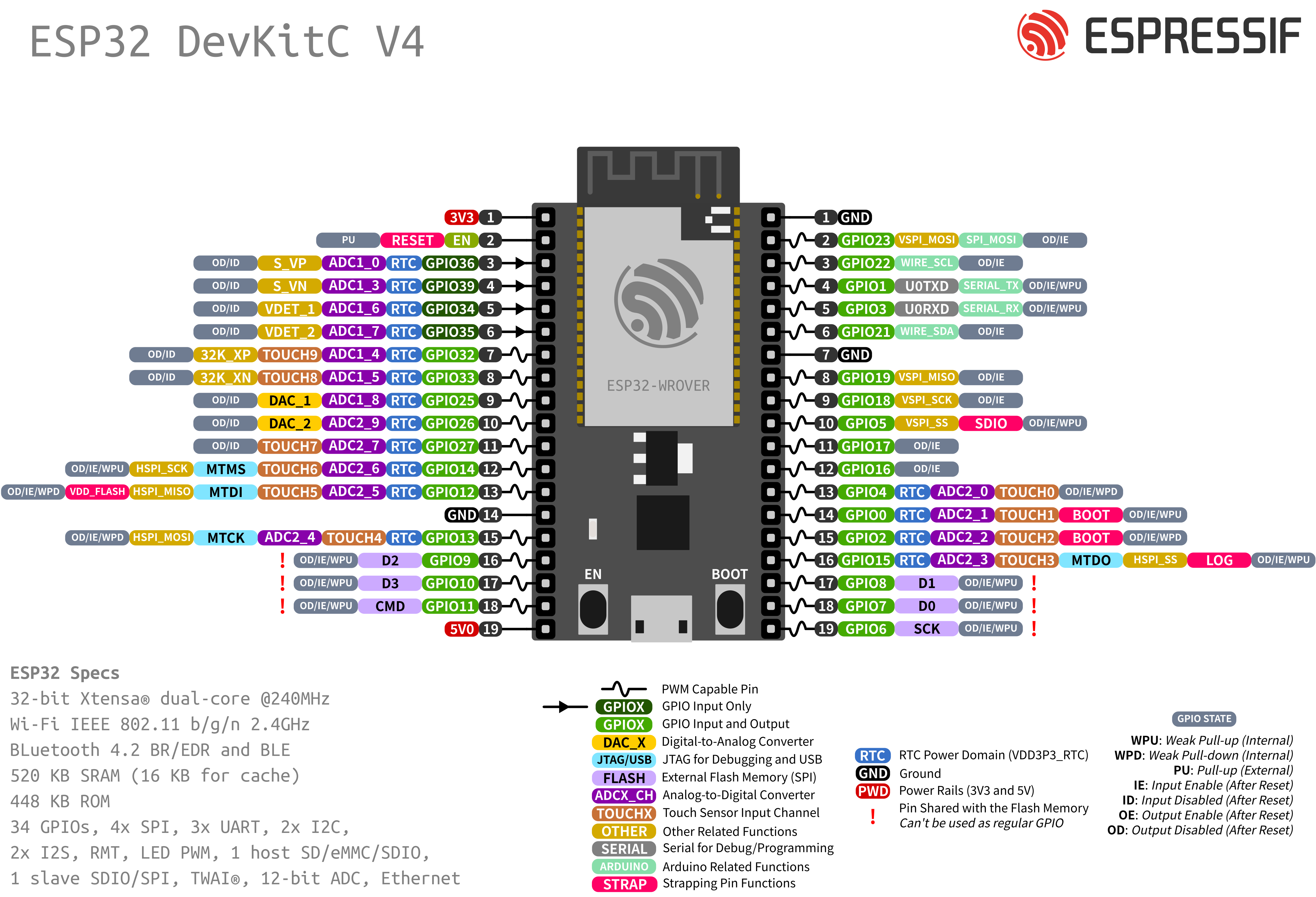

hi all,
could any body share where is offical detailed pinout of ESP32 dev board (not of chip pinout, nor module pinout) from esp32, the kind of definition of every pin, not a brief like https://docs.espressif.com/projects/esp ... escription . I think somewhere should have and tried but can't find.
in constrait, there is detailed pinout of arduino nano: https://store.arduino.cc/usa/arduino-nano inside DOCUMENTATION tablesheet
thank you in advance.

It's not in one single document, but... The pins are simply directly connected to the ESP32 module and the ESP32 chip inside (see e.g. the schematics) and the datasheet has all the descriptions for the pins.

If you are looking for the ESP32-DevKitC, this could help you.

thank you very much, that is extactly what I want. more ever, could you share where it from? :)

We are working on those images for the documentation and as soon as it became available, it will be added to the official repositories.
For now you cant find it except from here and https://github.com/espressif/arduino-esp32/pull/5133.
