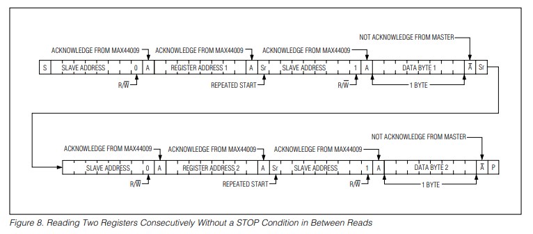

I have been trying to use MAX44009 light sensor, it stores the illumination data in two registers and the datasheet specifies that they need to be read one after another without generating a stop signal in between the two reads. Otherwise the two values may be out of sync.
I have not figured out a way how to set up the communication in ESP-IDF (on ESP32) so that no stop signal is sent between the two reads.
That is how the communication is supposed to be done:
This is my code that does not work:

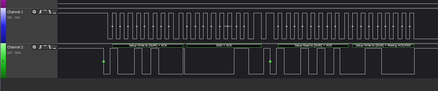

I have hooked up a logic analyzer and I can see that it does not clock the ACK or NAK after the first read and times out there:
Logic analyzer.jpg (65.23 KiB) Viewed 5399 times
The second read is never started. If I add a stop signal between the two reads, everything works, but there is a risk that the two values may be out of sync with each other.

This was the first thing that I tried. It does not work and times out similarly to using two command links. Logic analyzer shows that it gets stuck after reading the first byte.
