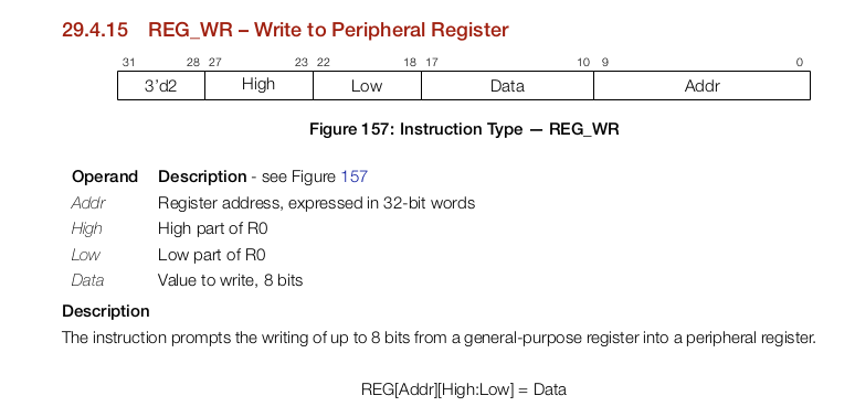

I've just now realized, that the C macros used in the ULP programs, like WRITE_RTC_REG, do not accept register values (r0, r1, etc).
Is there a way around that? I've got a register that contains the RTCIO pin number of the pin I'd like to control, but I've got no way to use that value to actually write to the pin's register.
Example:
move	r0, 14
// Doesn't work
WRITE_RTC_REG(RTC_GPIO_OUT_W1TS_REG, RTC_GPIO_OUT_DATA_W1TS_S + r0, 1, 1)
// Works
WRITE_RTC_REG(RTC_GPIO_OUT_W1TS_REG, RTC_GPIO_OUT_DATA_W1TS_S + 14, 1, 1)
The error is
Error: syntax error. Input text was r0.

There's no (reasonable) way to actually modify register write instructions at runtime, but if this is representative of what you need to do then it might be feasible to include *all* possible instructions and jump to the one you need.
eg:

EnifCH
Joined: Wed Jan 04, 2023 10:43 am
Re: Call WRITE_RTC_REG in ULP using value from a register
Postby EnifCH » Thu Jan 05, 2023 10:14 am
I know that this thread is quite old, but maybe some other people struggle with the same problem and will find my solution to the problem useful...
I was trying to implement a ULP based blinking alarm on one of my projects. As the code is highly configurable at run time, I wanted the RTC GPIO pin used for blinking not to be hard coded, and this way stumbled on the same problem as the originator of this thread, i.e. that register writes need hard coded pin numbers... I was glad to find the solution here with the explicit enumeration of the pins in a kind of instruction array, using a programmed jump to go to the right instruction for the selected pin.
However, given the very limited space for ULP programs (using about 80% of the available space just for the 2*18 register writes and corresponding jumps), I continued to search for some way to avoid the 18 repetition of the REG_WR/JUMP instructions. I first tried to modify the instruction directly from within the main CPU program, by defining a global label and overwriting it in my main sketch. This compiled well, but gave a write protection error at run time, obviously the ULP program memory (.text section) is protected.
But as I can write to the data section, I simply moved the WRITE_RTC_REG and a JUMP instruction into the .data section and gave it a global label. This works! So I can now modify the WRITE_RTC_REG instruction to write to the desired pin at run time.
Here is my little ULP program with the WRITE_RTC_REG moved to the .data section

This ULP program uses only 64 bytes program storage, compared to more than 400 in the version with the computed jumps.
In my sketch I use the following sequence to modify the instructions at the setpin and clearpin labels:
extern uint32_t ulp_setpin; // REG_WR instruction to set RTC_GPIO pin
extern uint32_t ulp_clearpin; // REG_WR instruction to clear RTC_GPIO pin
uint32_t bit = rtcpin+14;                  // rtcpin is the RTC_GPIO pin (0-17),  14 is the bit position of
ulp_setpin&=0xf003ffff;                    // mask off bits 18-27
ulp_setpin|=(bit<<18)|(bit<<23);    // modify from and to bit to read
ulp_clearpin&=0xf003ffff;                 // mask off bits 18-27
ulp_clearpin|=(bit<<18)|(bit<<23); // modify from and to bit to read
For a better understanding of the above, I added an excerpt of the ESP32 technical reference manual page 601 as attachment which shows the bit structure of the REG_WR instruction.
I still wonder, if there is some way to modify the instructions in the .text section directly, i.e. to overcome the write protect error - maybe someone else knows?
