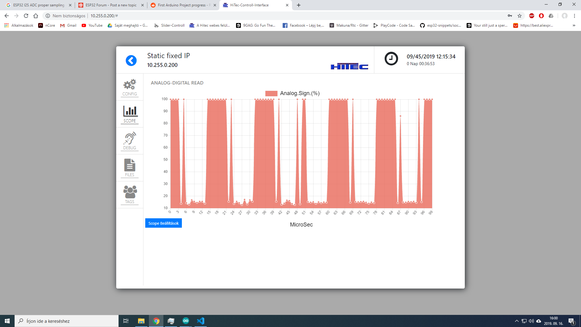

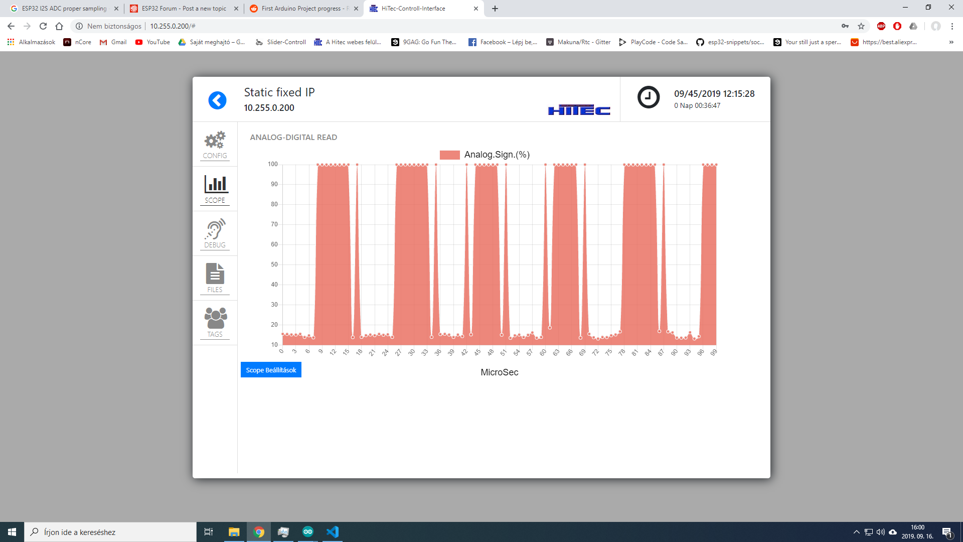

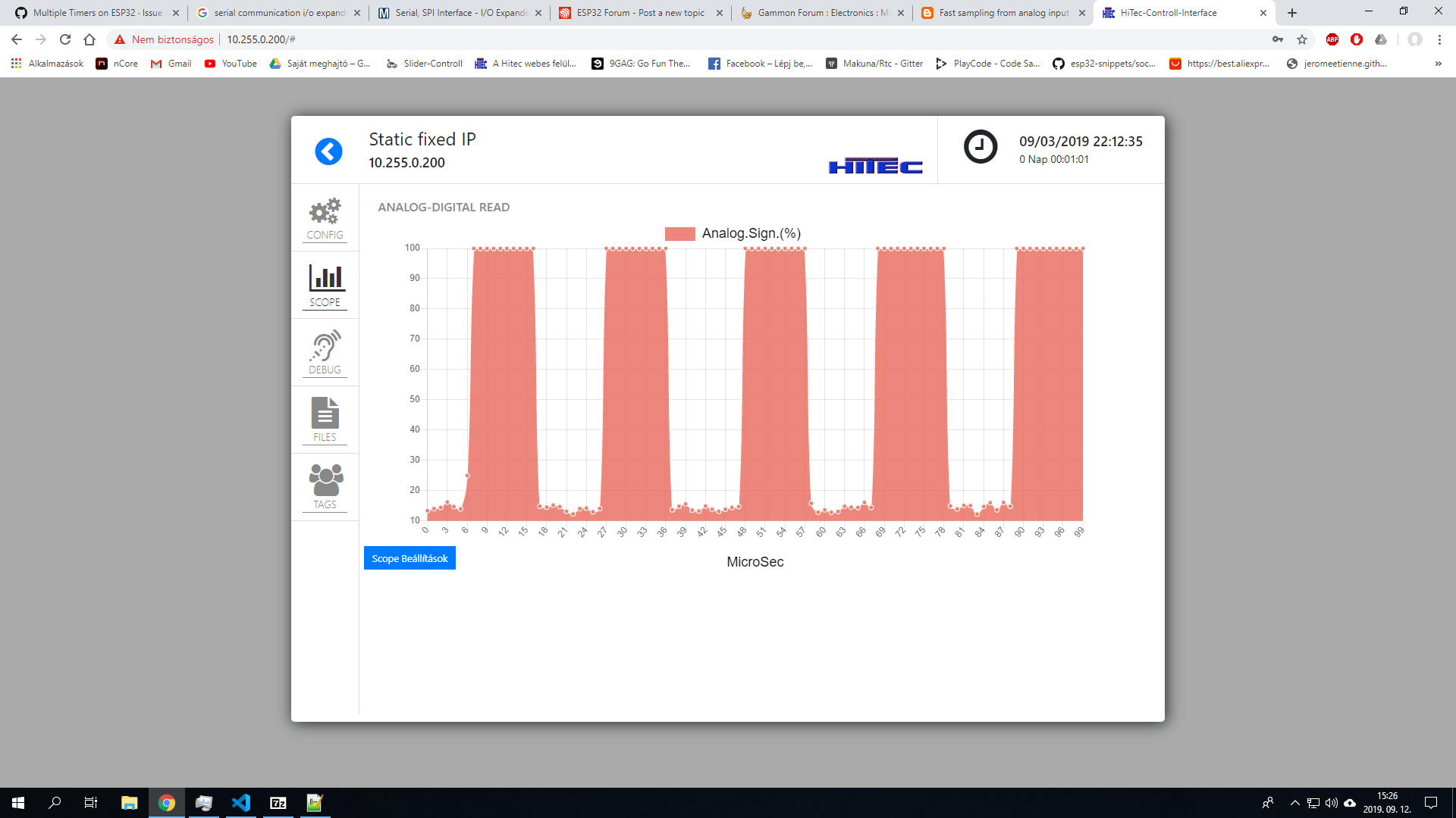

Hello guys!
I experiencing some strange signals with i2s dma.
I'am using esp32 with PlatformIO in vscode IDE and using Arduino framework.
The esp is measuring a 4khz signal at 80.000hz right now.
And the signals that i'am getting are strange. ( The signal is coming from a signal generator ).
Code to reproduce:

The signals that iam getting:
(Last two pictures.)
The signals that iam expecting:
(First picture. This is using simple analog-read with a for loop.)
Signal using analogRead() with a for loop.
Képernyőfelvétel (9).png (187.58 KiB) Viewed 8677 times

The strange thing is, that if i use an other ADC1 PIN on the esp32
and read the i2s data from the first PIN, the signal is there with some more "noise".

Postby zekageri » Thu Sep 19, 2019 7:06 am
My problem is solved.
I just had to switch the channel format in the i2s config to "all left"
My i2S config is looks like this now:
