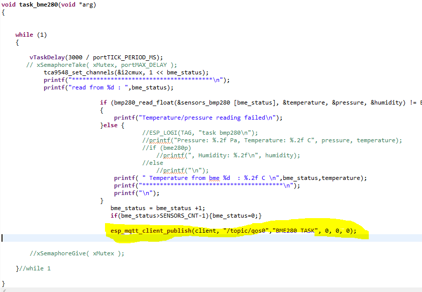

GirishHolla
Posts: 15
Joined: Tue Jun 01, 2021 10:21 am
Re: How to use ESP-MQTT in a correct way (event loop)?
Postby GirishHolla » Tue Jun 01, 2021 10:25 am
As you mentioned as "publish call" in freertos task but how client is defined within it (with reference to screenshot).kindly let me know,

Posts: 10599
Postby Sprite » Wed Jun 23, 2021 2:27 am
You declare the client globally, but initialize it in e.g. your main function. Something like this:
 static esp_mqtt_client_handle_t client;
 void app_main() {
 	client = esp_mqtt_client_init(&mqtt_cfg);
