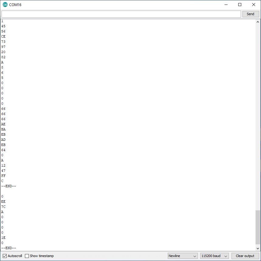

UPD:
Attached the example of received bytes from UART buffer.
All the shown bytes were sent to ESP32 as a single pack of data. --END-- line represents the point, where Serial2.available / Serial2.read think the Rx buffer is now empty. After interracting with Serial port (UART with PC) (for example sending something via serial monitor of Arduino IDE), ESP32 detects the rest of the received bytes.
The tested code is provided below.
void setup()
Serial.begin(115200);
Serial2.begin(115200, SERIAL_8N2);
void loop()
while (Serial2.available()>0)
Serial.println(Serial2.read(), HEX);
i=1;
delay(10);
if (i==1)
Serial.println("--END--");
Serial.println(" ");
i=0;
delay(100);
