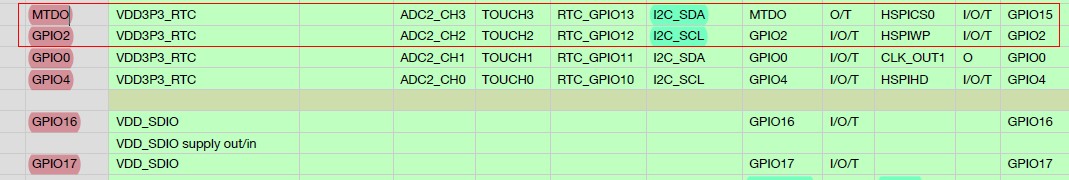

1、GPIO15 & GPIO2 Used as IIC interface for sensors。If the other ports can use for PWM?
2、The Hall sensor I need four ports(2-way A and B phase),does the ESP32-D0WDQ6 support?

1. Both IIC and PWM could be mapped to any GPIO via IO_matrix, what you denote are default IIC pin from IO_MUX. So feel free to select other GPIOs as IIC.
2. ESP32 does not support this function.
