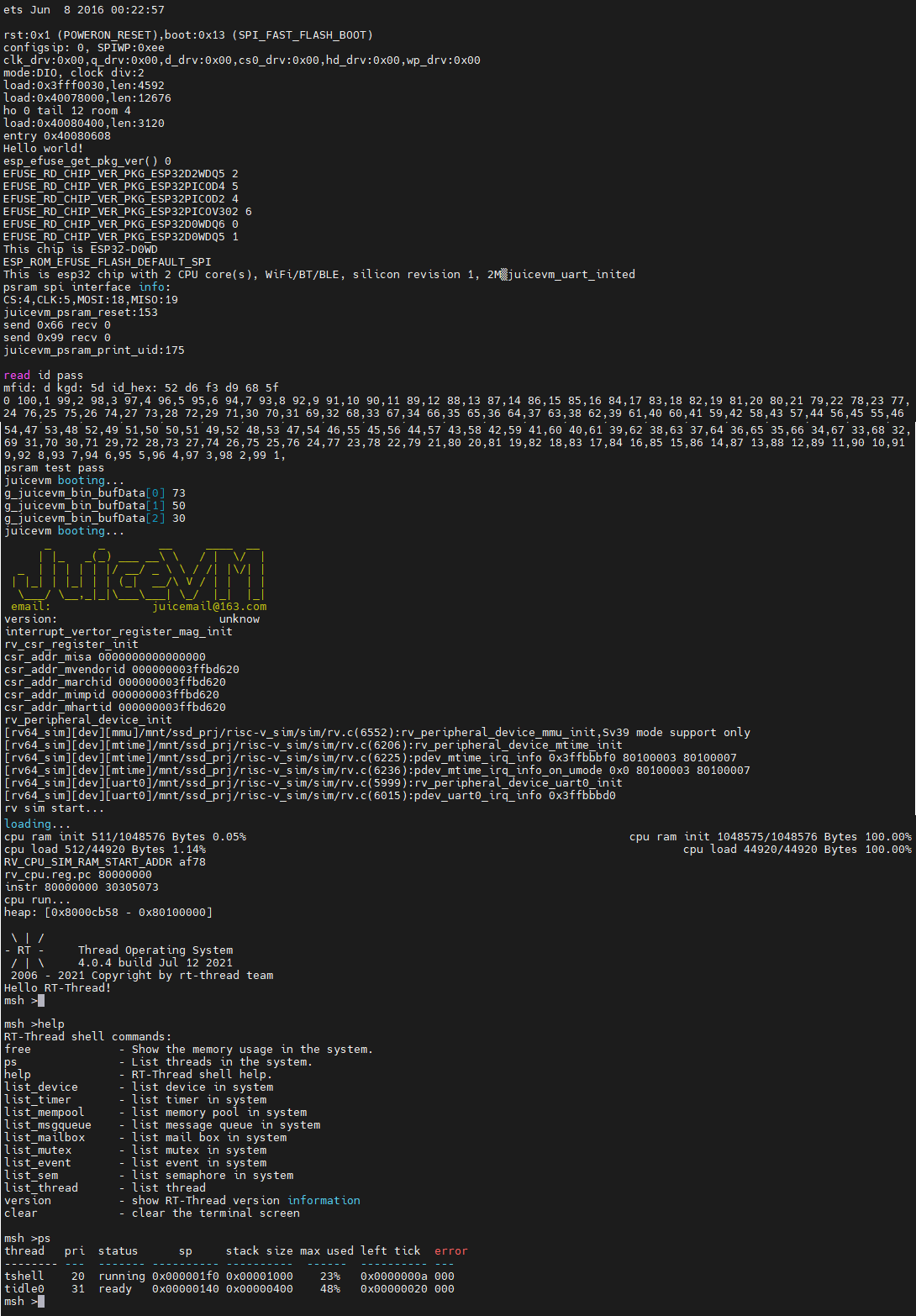

i port juicevm what is a Risc-V VM to esp idf and boot linux on esp32
juiceRv
Joined: Sat Jul 17, 2021 9:11 am
Postby juiceRv » Sat Jul 17, 2021 9:20 am
RT
boot linux 5.0.0 on esp32 :D
repo link:https://github.com/juiceRv/JuiceVm
twitter link:https://twitter.com/xiaohui10556190/sta ... 8991604739
whycan link: https://whycan.com/p_66202.html
firmware file download:
boot env:
esp32 devkit v1 develop board:
extern 2MB flash.
extern spi psram 8MB:
psram spi interface info:
CS:4,CLK:5,MOSI:18,MISO:19
download log:
Compressed 1583728 bytes to 1294532...
Wrote 1583728 bytes (1294532 compressed) at 0x00001000 in 33.1 seconds (effective 382.7 kbit/s)...
https://github.com/juiceRv/JuiceVm/raw/ ... 141900.zip
#define JUICEVM_PSRAM_DMA_CHAN 2
#define JUICEVM_PSRAM_PIN_NUM_MISO 7
#define JUICEVM_PSRAM_PIN_NUM_MOSI 8
#define JUICEVM_PSRAM_PIN_NUM_CLK 17
#define JUICEVM_PSRAM_PIN_NUM_CS 16
https://github.com/juiceRv/JuiceVm/raw/ ... 210717.zip
