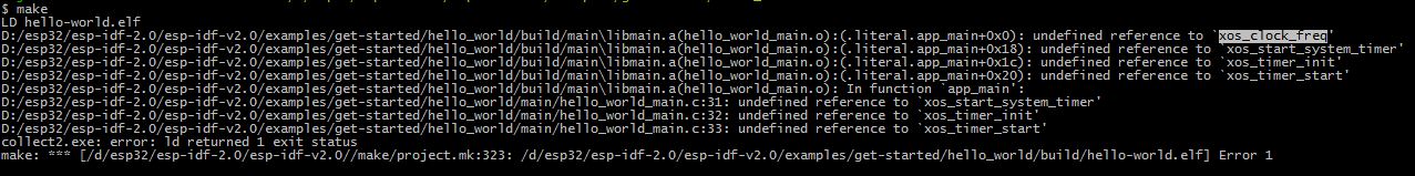

I tried using Xtensa Timers , using xos.h and xos_timer.h. There are compilation errors and xos_clock_freq undefined error. Any config changes required for using Xtensa Timer APIs. I had set esp32 clock freq as 80MZ.

hey Abhiram,I tried using Xtensa Timers , using xos.h and xos_timer.h. There are compilation errors and xos_clock_freq undefined error. Any config changes required for using Xtensa Timer APIs. I had set esp32 clock freq as 80MZ.
have a look at this,
i've also encountered the same linking error but along with some more undefined references to xos_timer functions. but i'm not clear about which lib file to add and where to add. do u have any idea regarding this?

You can refer to FreeRTOS port layer code for an example of how these timers are used (portasm.S). In C, RSR and WSR macros can be used to read and write CCOUNT and CCOMPAREx registers.
xos functions mentioned above can not be used in IDF because IDF doesn't include corresponding libraries or source files. The header files are still present for some historical reason.
I do suggest trying the hardware timers (TimerGroup peripherals) instead of Xtensa timers, as these are documented in the TRM and there is an example illustrating their use in ESP-IDF.
