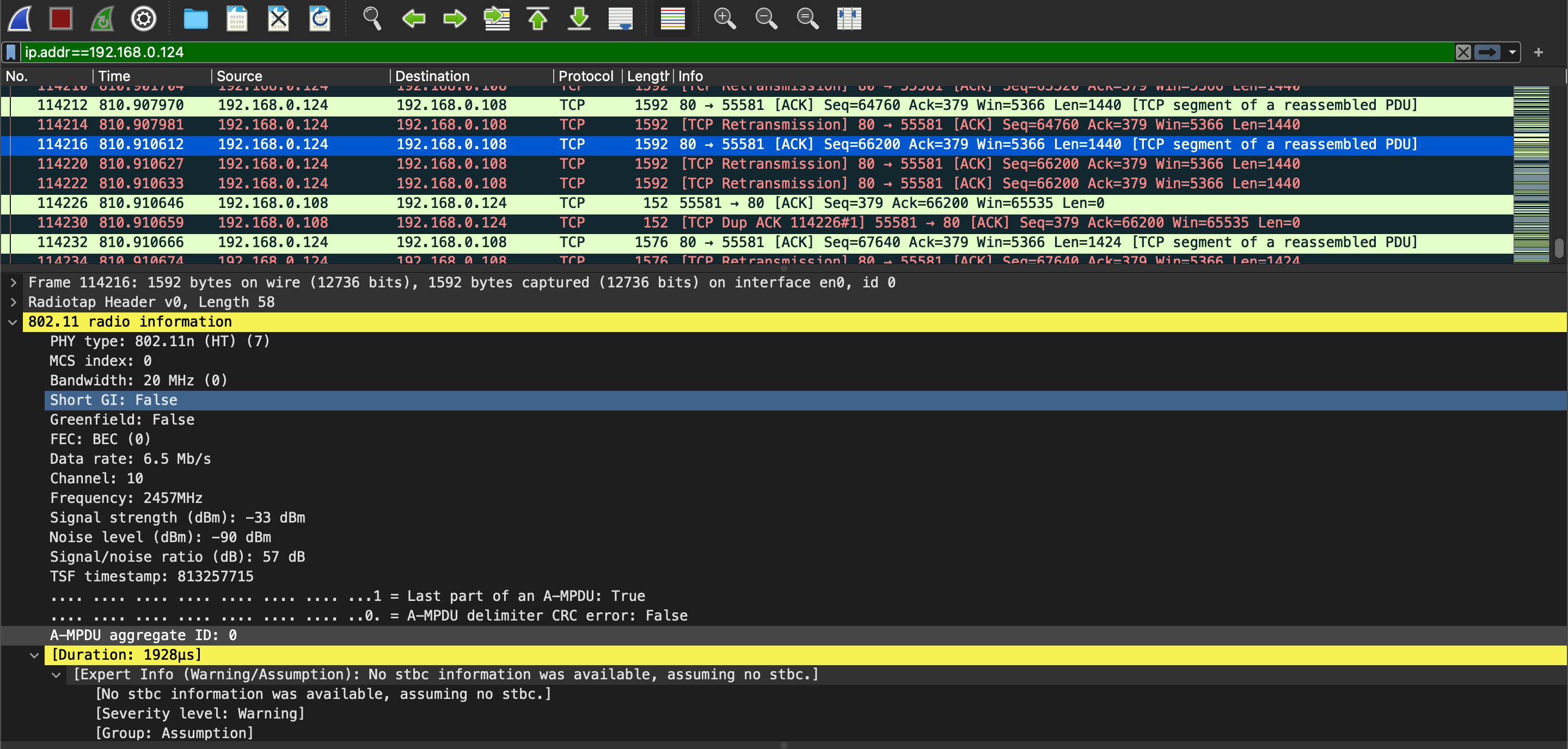

UPDATE
It looks like this is some trouble in WiFi or LWIP..
Using Wireshark I see a loot of TCP retransmissions - see attachments.
I'll try to survey on lower layers.
I still hope that this post was read by somebody from Espresiff...
Screenshot 2021-08-01 at 17.22.36.png (700.81 KiB) Viewed 14815 times

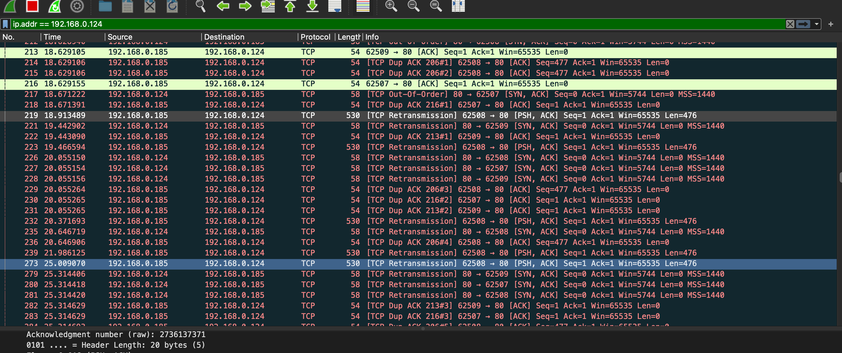

Another update.
After hours of testing with esp32_cam firmware, I've got really unstable results. I tried IDF 4.1 and 4.3 - no remarkable difference.
Sometimes, it sends ~100 KB in 300 ms, sometimes in 11000 ms!!! I can't measure actual WiFi readio-channel load, but it looks very strange, because I tried with usage other devices in the same network, doing yotube watching, online gaming, files downloading - via WiFi, and I couldn't detect clear corellation.
But I've found another interesting point - it looks like ESP doesn't receive some TCP packets. An example from the attached picture: the packet with seq=66200 - ACK was sent by ESP (ESP has 192.168.0.124) in #114216, but immediately it also was repeated in retransmissions in #114220 and #114222. After, it was ACKed to ESP by host in #114226, and also with duplication.
Time between #114216 and #114226 is 34 us. Why was this retransmission happened?
The router is Tp-Link Archer C2 v.3 with original FW (EU version). Placen in 4 meters, behind thin wall (10 cm gipsum wall).
The screenshot was taken from Wireshark being runned on a macbook whick was placed in 20 cm from ESP. WiFi radio levels are pretty good close to ESP:
Signal: -33 dBm
Noise: -90 dBm
SNR: 57 dBm
The packets were captured while transmission of a shot with ~100KB in ~3000 ms.
What's happening??...
Screenshot 2021-08-01 at 22.04.55.png (525.38 KiB) Viewed 14788 times
