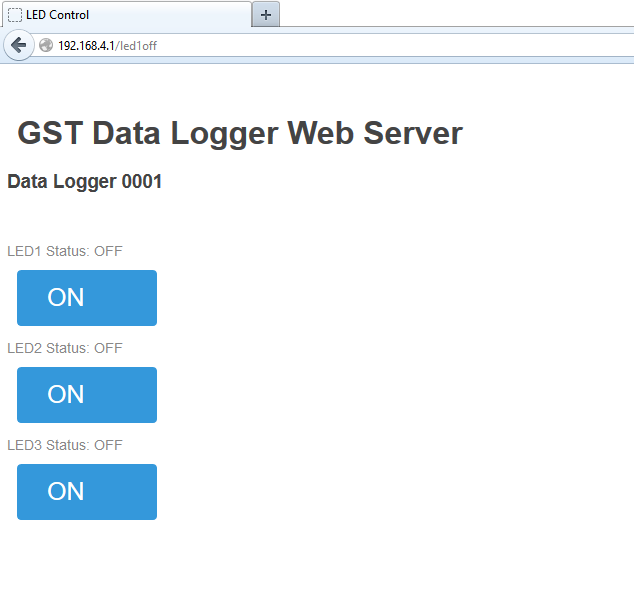

I am trying to create a web page using an esp32 as an AP. I want my ESP32 board to be an AP that the user can log onto and then go to a webpage address and read and set values for the board. Set text values to name signals, update sensor readings from the board, etc. I can do this in Arduino but am having a difficult time in Eclipse with the ESP32 IDF.
Can anyone provide sample code on how to create a client server and do the above? I'm new to ESP32 IDF so I'm really at a loss as to how to proceed. I've got all the example projects such as softAP and simple server running, it's the code to implement the client server to respond to a user logging onto the AP/webpage that I am having trouble with.
Any help/direction would be greatly appreciated.
Thanks

I cannot post PM's either at the moment. Below is the Arduino code to implement the web page. This is what I'm trying to port to Eclipse and the ESP32 IDF. Maybe this will give you and idea of what I'm trying to achieve. The web page is shown. I copied a picture of the web page to this post. Basically it is 3 button controls that turn on/off 3 LED's on my target board.
Thanks
Arduino Code:
#include <WiFi.h>
#include <WebServer.h>
/* Put your SSID & Password */
const char* ssid = "Data Logger 0001"; // Enter SSID here
const char* password = "12345678"; //Enter Password here
/* Put IP Address details */
IPAddress local_ip(192,168,1,1);
//IPAddress gateway(192,168,1,1);
//IPAddress subnet(255,255,255,0);
WebServer server(80);
uint8_t LED1pin = 32;
bool LED1status = LOW;
uint8_t LED2pin = 33;
bool LED2status = LOW;
uint8_t LED3pin = 25;
bool LED3status = LOW;
void setup() {
Serial.begin(115200);
pinMode(LED1pin, OUTPUT);
pinMode(LED2pin, OUTPUT);
pinMode(LED3pin, OUTPUT);
WiFi.softAP(ssid, password);
//bm added the next line and commented out the line WiFi.softAPConfig(local_ip, gateway, subnet);
IPAddress myIP = WiFi.softAPIP();
//Original code next line
//WiFi.softAPConfig(local_ip, gateway, subnet);
//bm added the next 2 lines
Serial.print("AP IP address: ");
Serial.println(myIP);
server.begin();
delay(100);
server.on("/", handle_OnConnect);
server.on("/led1on", handle_led1on);
server.on("/led1off", handle_led1off);
server.on("/led2on", handle_led2on);
server.on("/led2off", handle_led2off);
server.on("/led3on", handle_led3on);
server.on("/led3off", handle_led3off);
server.onNotFound(handle_NotFound);
server.begin();
Serial.println("HTTP server started");
void loop() {
server.handleClient();
if(LED1status)
{digitalWrite(LED1pin, HIGH);}
else
{digitalWrite(LED1pin, LOW);}
if(LED2status)
{digitalWrite(LED2pin, HIGH);}
else
{digitalWrite(LED2pin, LOW);}
if(LED3status)
{digitalWrite(LED3pin, HIGH);}
else
{digitalWrite(LED3pin, LOW);}
void handle_OnConnect() {
LED1status = LOW;
LED2status = LOW;
LED3status = LOW;
Serial.println("GPIO32 Status: OFF | GPIO33 Status: OFF| GPIO25 Status: OFF");
server.send(200, "text/html", SendHTML(LED1status,LED2status,LED3status));
void handle_led1on() {
LED1status = HIGH;
Serial.println("GPIO32 Status: ON");
void handle_led1off() {
LED1status = LOW;
Serial.println("GPIO32 Status: OFF");
void handle_led2on() {
LED2status = HIGH;
Serial.println("GPIO33 Status: ON");
void handle_led2off() {
LED2status = LOW;
Serial.println("GPIO33 Status: OFF");
//bm add
void handle_led3on() {
LED3status = HIGH;
Serial.println("GPIO25 Status: ON");
void handle_led3off() {
LED3status = LOW;
Serial.println("GPIO25 Status: OFF");
void handle_NotFound(){
server.send(404, "text/plain", "Not found");
String SendHTML(uint8_t led1stat,uint8_t led2stat,uint8_t led3stat){
String ptr = "<!DOCTYPE html> <html>\n";
ptr +="<head><meta name=\"viewport\" content=\"width=device-width, initial-scale=1.0, user-scalable=no\">\n";
ptr +="<title>LED Control</title>\n";
//ptr +="<style>html { font-family: Helvetica; display: inline-block; margin: 0px auto; text-align: center;}\n";
ptr +="<style>html { font-family: Helvetica; display: inline-block; margin: 0px auto; text-align: left;}\n";
//ptr +="body{margin-top: 50px;} h1 {color: #444444;margin: 50px auto 30px;} h3 {color: #444444;margin-bottom: 50px;}\n";
ptr +="body{margin-top: 50px;} h1 {color: #444444;margin: 10px;} h3 {color: #444444;margin-bottom: 50px;}\n";
//ptr +=".button {display: block;width: 80px;background-color: #3498db;border: none;color: white;padding: 13px 30px;text-decoration: none;font-size: 25px;margin: 0px auto 35px;cursor: pointer;border-radius: 4px;}\n";
ptr +=".button {display: block;width: 80px;background-color: #3498db;border: none;color: white;padding: 13px 30px;text-decoration: none;font-size: 25px;margin-left: 10px;cursor: pointer;border-radius: 4px;}\n";
ptr +=".button-on {background-color: #3498db;}\n";
ptr +=".button-on:active {background-color: #2980b9;}\n";
ptr +=".button-off {background-color: #34495e;}\n";
ptr +=".button-off:active {background-color: #2c3e50;}\n";
ptr +="p {font-size: 14px;color: #888;margin-bottom: 10px;}\n";
ptr +="</style>\n";
ptr +="</head>\n";
ptr +="<body>\n";
ptr +="<h1>GST Data Logger Web Server</h1>\n";
ptr +="<h3>Data Logger 0001</h3>\n";
if(led1stat)
{ptr +="<p>LED1 Status: ON</p><a class=\"button button-off\" href=\"/led1off\">OFF</a>\n";}
else
{ptr +="<p>LED1 Status: OFF</p><a class=\"button button-on\" href=\"/led1on\">ON</a>\n";}
if(led2stat)
{ptr +="<p>LED2 Status: ON</p><a class=\"button button-off\" href=\"/led2off\">OFF</a>\n";}
else
{ptr +="<p>LED2 Status: OFF</p><a class=\"button button-on\" href=\"/led2on\">ON</a>\n";}
if(led3stat)
{ptr +="<p>LED3 Status: ON</p><a class=\"button button-off\" href=\"/led3off\">OFF</a>\n";}
else
{ptr +="<p>LED3 Status: OFF</p><a class=\"button button-on\" href=\"/led3on\">ON</a>\n";}
ptr +="</body>\n";
ptr +="</html>\n";
return ptr;
ptr +="</style>\n";
ptr +="</head>\n";
ptr +="<body>\n";
if(led1stat)
else
if(led2stat)
else
if(led3stat)
else
ptr +="</body>\n";
ptr +="</html>\n";
return ptr;
- web page.PNG (18.18 KiB) Viewed 7967 times
