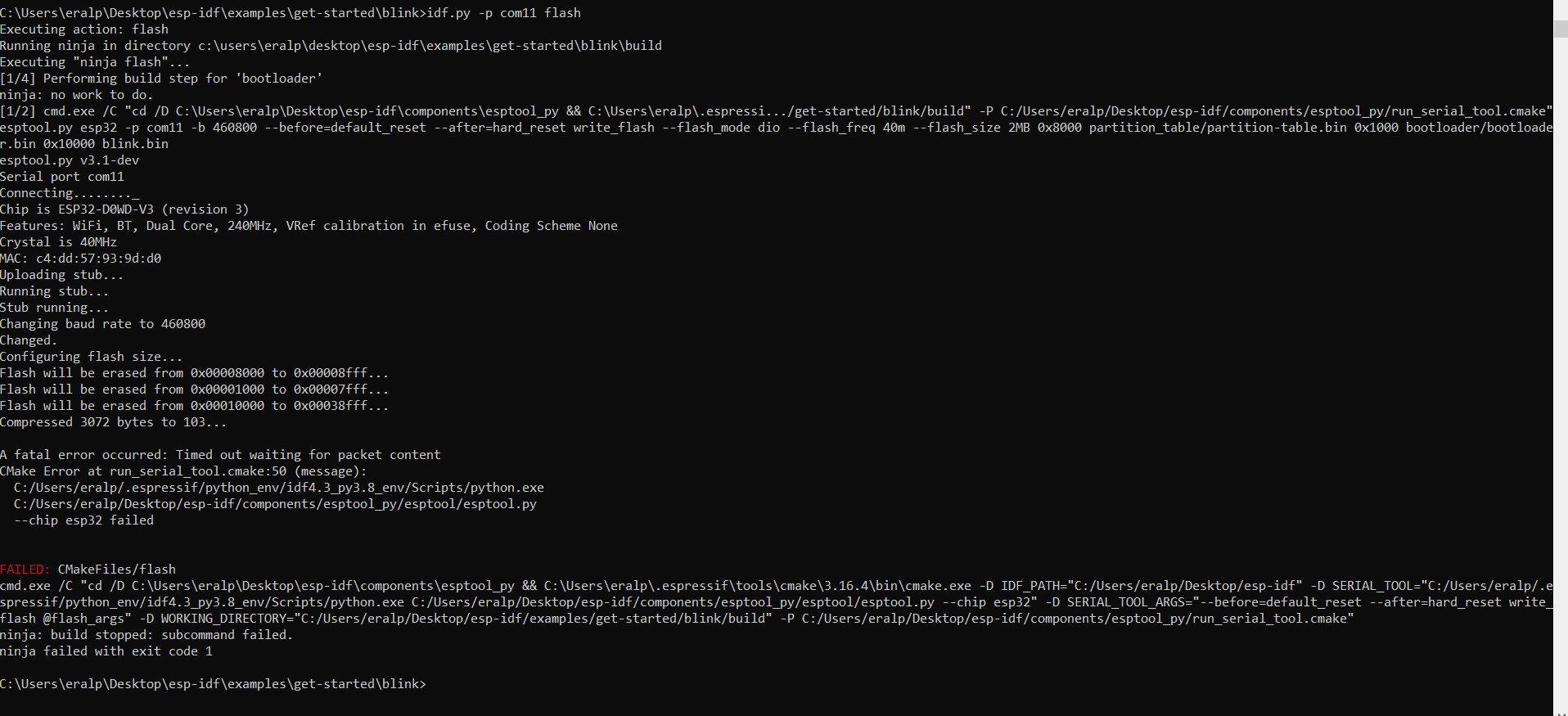

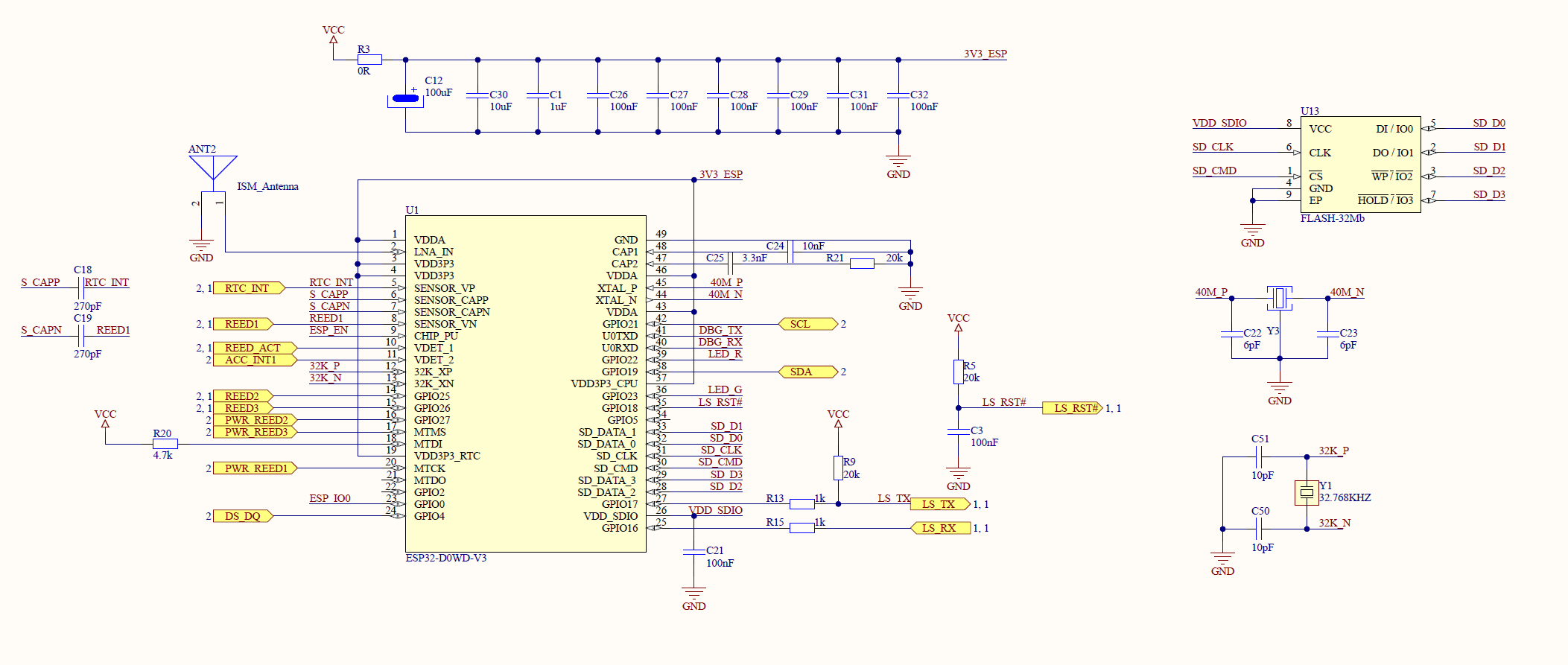

Please find below the Schematic of the ESP32-D0WD SOIC based design.
I am able to detect chip as well as all technical parameters of ESP32 when I try to flash a code over chip but after that, I think Flash does not respond and it fails and got some error.
I use W25Q16JVZPIQ flash (it's 16Mb / 2MB)
Also, I am able to erase the flash, and the command working fine.
Also, there is a small bit of communication done between ESP32 and Flash than its Fail as per log of command.
May I know what is the issue??
Hello, world example code we try to flash and I think that 2MB flash is enough and Good with ESP32.
We try a lot but were not able to figure out the issue Maybe ESP32 does not enter into boot mode but I am not sure so please help me to solve this issue.

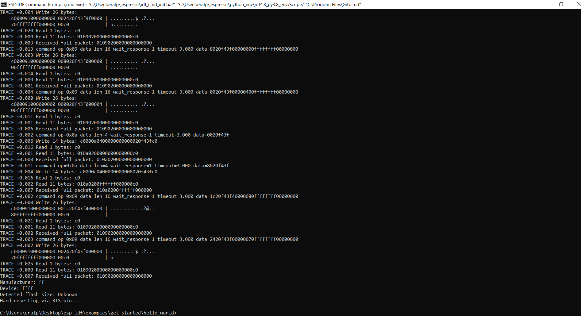

I have tried to read the flash Id using the command "esptool.py --trace flash_id" and I see it reads 0xFF which i think is wrong.
TRACE +0.025 Read 1 bytes: c0
TRACE +0.000 Read 11 bytes: 01090200000000000000c0
TRACE +0.007 Received full packet: 01090200000000000000
Manufacturer: ff
Device: ffff
Detected flash size: Unknown
Hard resetting via RTS pin...

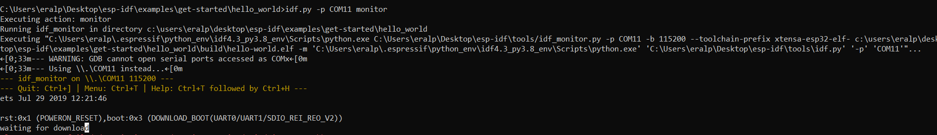

Meanwhile, I also verified that the chip enter successfully in to bootloader mode here is the log.
--- idf_monitor on \\.\COM11 115200 ---
ets Jul 29 2019 12:21:46
rst:0x1 (POWERON_RESET),boot:0x3 (DOWNLOAD_BOOT(UART0/UART1/SDIO_REI_REO_V2))
waiting for download

Postby Sprite » Mon Aug 23, 2021 2:13 am
Your schematic looks OK to me; are you sure your board itself matches the schematic (as in: no solder bridges, badly soldered joints etc)? Do you have multiple boards to test this on?

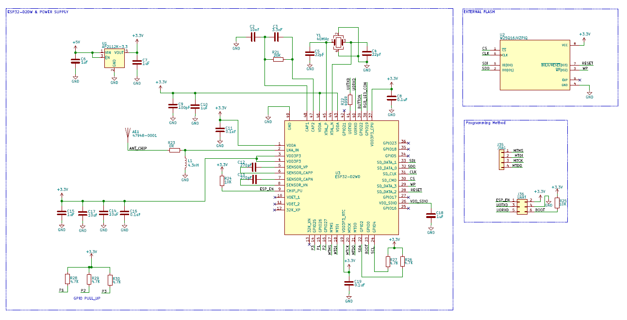

I have the same problem with ESP32-D0WD-V3. Using it with MX25R3235FM2IH0 which is 1.65V ~ 3.6V so I can use power it both using 3.3V or 1.8V (doesn't work either way). I also tried soldering GD25LQ32DSIGR instead (and using it with 1.8V of course) - also didn't work.
Enclosed is my schematic.
