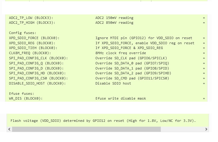

Hi
one trick you can do if you have the hardware - ( i have it not by the hand )
hold boot on connect so the innerside firmware does not start and comes firstly to the download mode, [i**]hold it all the time** [/i]( wire boot pin to GND ) you can use espefuse with the arg: summary
this tells you how the standard named pins are routed,( standard or "warped"/routed),overrided and so on,
also it tells you which VDD_ is used for the innerside flash / psram ( 1.2, 1.7, 1.8 ...3.3 ..or anything else ).

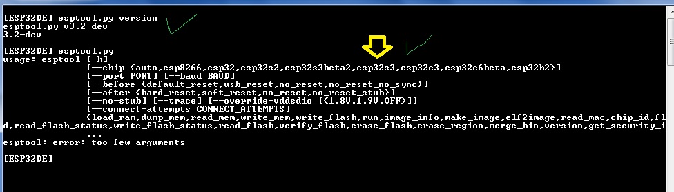

be sure you use the latest version, it comes with esptool, test does esptool support the esp32s3 (not esp32s3beta) with simply
call the esptool [-h]
hope this helps.
** you do not need do this, usually this does the tool, it is only a doing if you not want start the firmware on connect with supply/USB.. after your buy / get firsttime in use **
