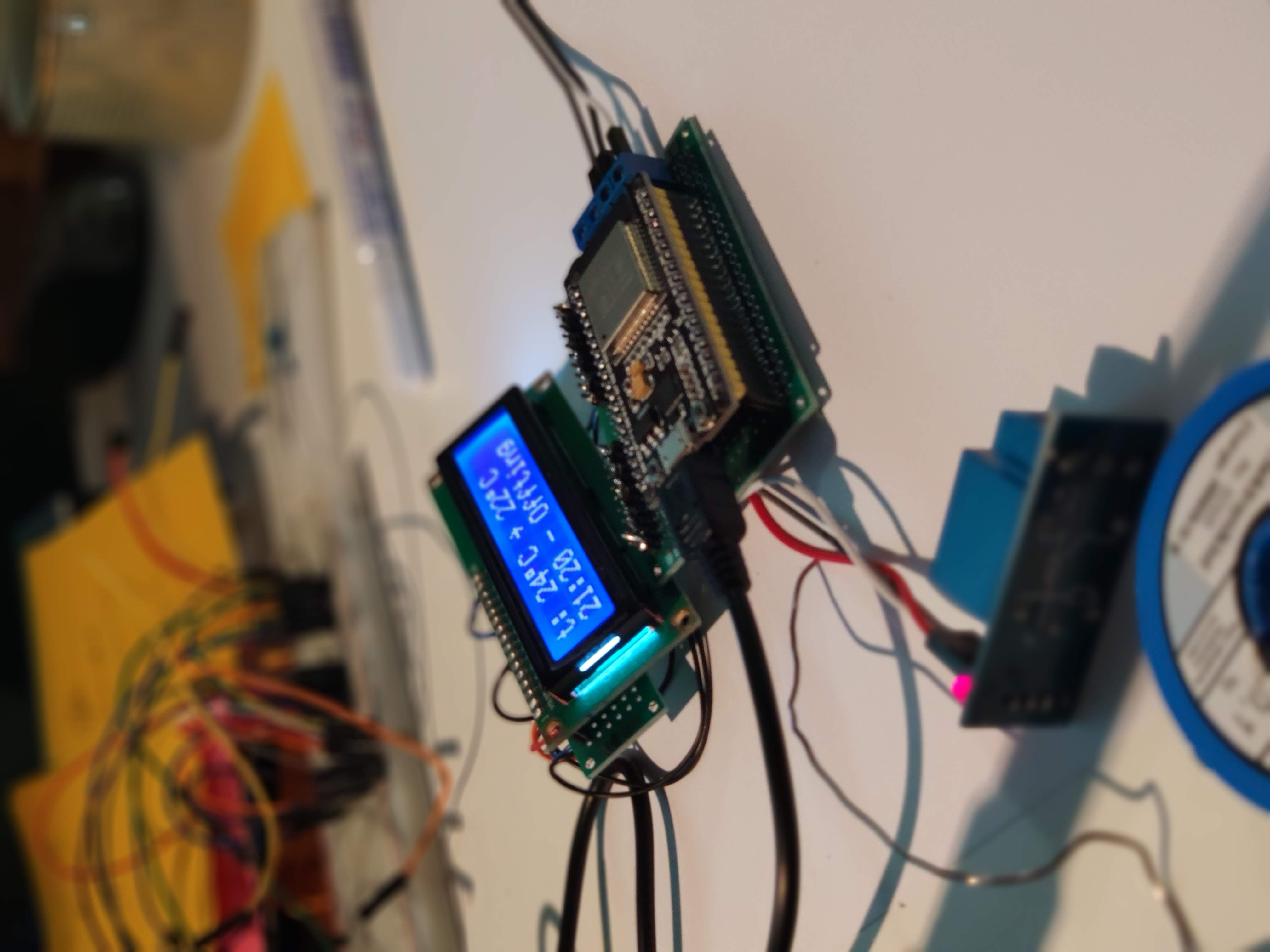

I just finished my first ESP32 project: A temperature controller using a simple temperature sensor and a relay to turn on/off a heating element for my ant-farm.
I have the wiring and all the components wired up and the script does exactly what it should. During development and testing the ESP32 was always connected and powered using USB on my Macbook (also using a USB A to USB C adaptor). Now, that I'm done, I wanted to use a USB charger to power the ESP32, but interestingly it does not work. The display glows up, but the content is not displayed (no script is being executed - Relay not working either) and the ESP32 is blinking its red LED (more or less consistently the whole time).
What I tried already is:

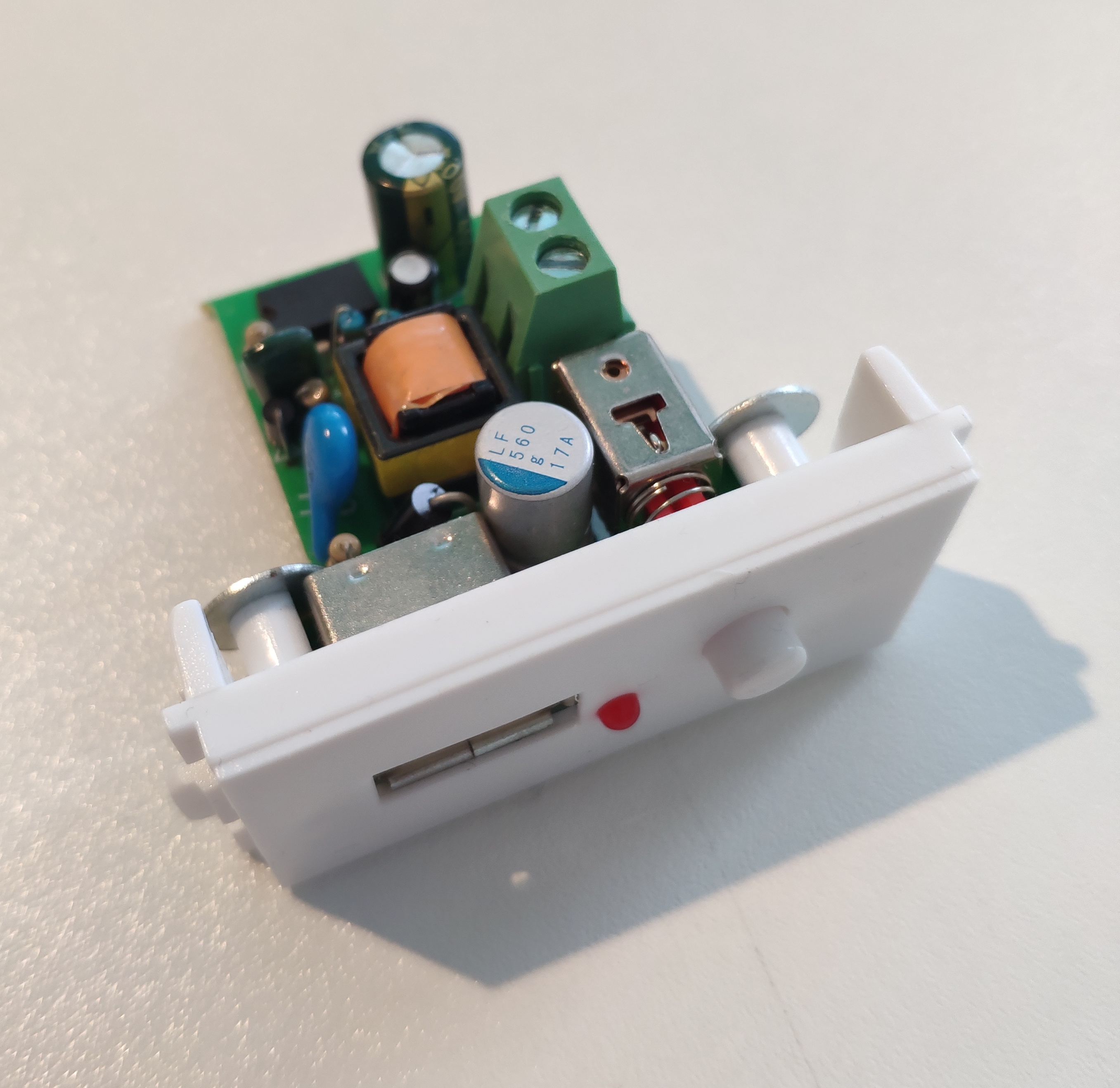

- A 230V to USB power supply (bare pcb with components. This was what I wanted to use in the end)

everything working with soldered PCBs. Powered using PC USB.

Current USB charger
