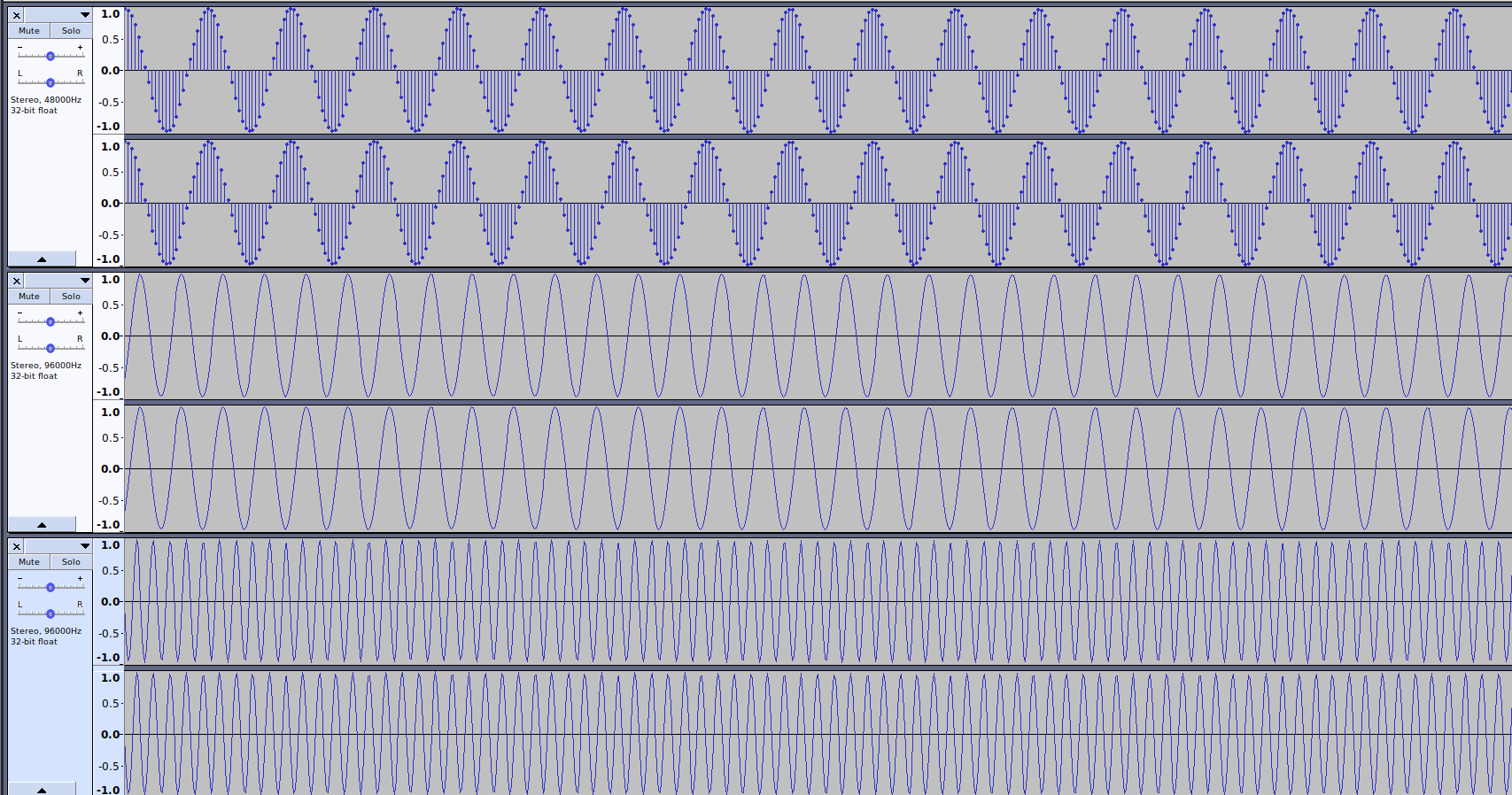

I wrote a test example to reproduce the issue you mentioned.
Here is the result: The data at the top line is at 48kHz sample rate with 2kHz sine input, middle line is at 96kHz sample rate with 2kHz input, bottom line is at 96kHz with 5kHz input. As you can see, I failed to reproduce this issue, maybe I should try another ADC codec.
For the reference and trouble shooting, this is my test project based on the latest master branch (by the way, the master branch on Github has not updated for several days, it should be synchronized sooner or later)
Platform: ESP32-LyraT-mini_V1.2 with ESP32-WROVER-B
Codec: ES8311
Signal Input: Generate sine wave at 2KHz & 5kHz by a signal generator
Sample rate: 48kHz & 96kHz
Stored data format: raw data

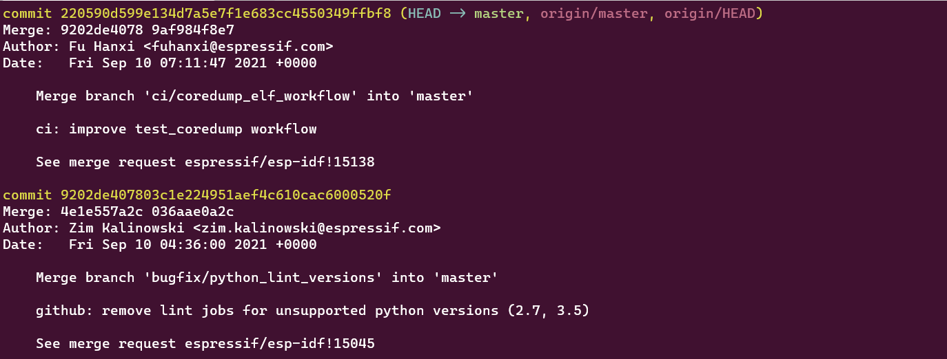

Thank you very much E-KAYA for sending me this details.
Now, let me try with your code. Instead of SD card, I am using flash memory to store output data of I2S.
Just want to clarify one thing is I am working on following commit id from master branch of ESP-IDF.
220590d599e134d7a5e7f1e683cc4550349ffbf8
Find attachment for more details.
I hope we are both on the same page.
Thanks.
Thanks.

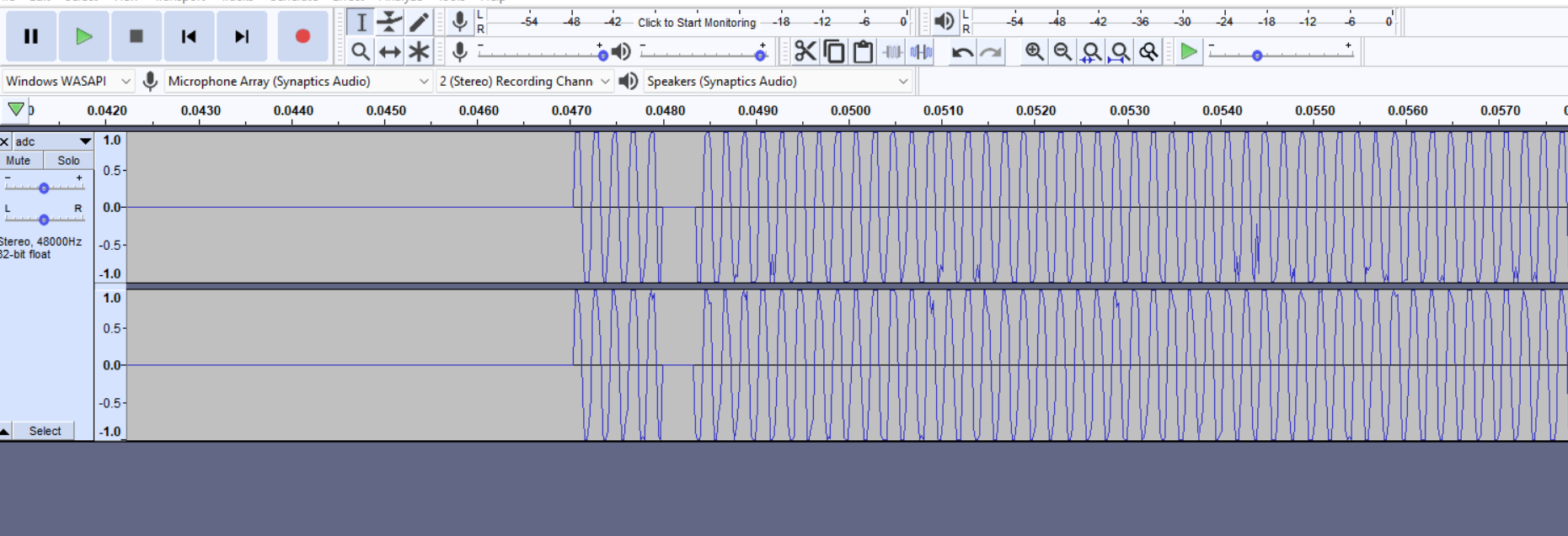

Dear E-KAYA,
I checked with your given code example. Gave the 5khz sine wave to external ADC, and start sample from ESP32 with 48000 freq.
I used ESP32 instead of ESP32-S3 board.
But still I am getting noise output data.
Please check attachment for your reference.
FYI, current setup ADC + ESP32 is working fine and and getting correct output in IDF v4.3.
Let us know what could be the next step to follow to make this work.
Thanks
Thanks

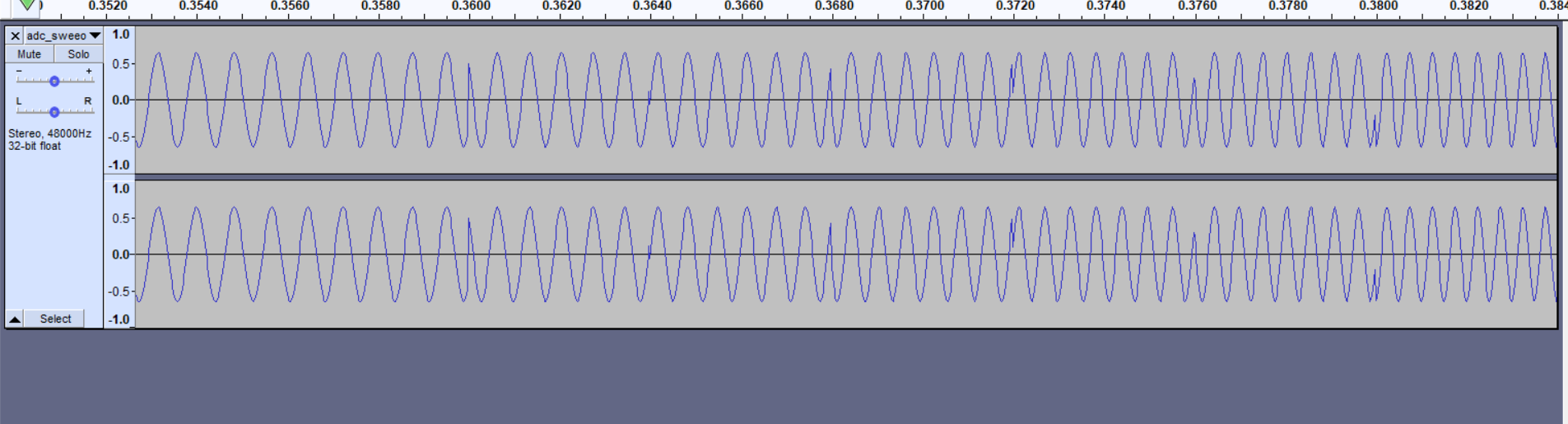

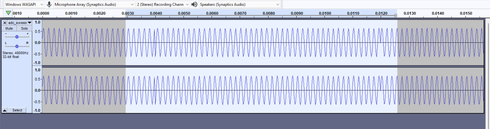

I am having different problem with I2S now.
By giving fix frequency(5k, 10k,15k etc.) sine wave from signal generator, ESP32S3 able to capture data correctly. I can see sine wave in audacity with fix frequency clearly.
Now instead of giving fix frequency as input, I an giving sweep sine wave from 500 Hz to 15 KHz as input with time period of 1 Sec,
If I do same test by just changing fix freq to sweep freq, Data sample is started to miss.
Find attached data file for your reference. You can clearly see missing data sample.
FYI, I have captured the sweep data by probing I2S using the logic analyzer and there is no any missing sample I have seen.
Looking forward to hearing from you soon.
Thanks.

Dear shailesh.korat,
Nice to hear your feedback! Seems you met another data lost problem, I need some time to test this issue, but recently I wrote a specific example for the data drop issue, you can have a try and hope it can help.
The key is to create at least two receive buffers, if one is under processing, the others can still receive the data from isr. In this way, we can lower the time cost in the `i2s_read` loop and improve the efficiency.
By the way, may I ask did you change the i2s configurations during sampling? If you called `i2s_set_clk` the buffer might be cleared.
Thanks!
Thanks!
