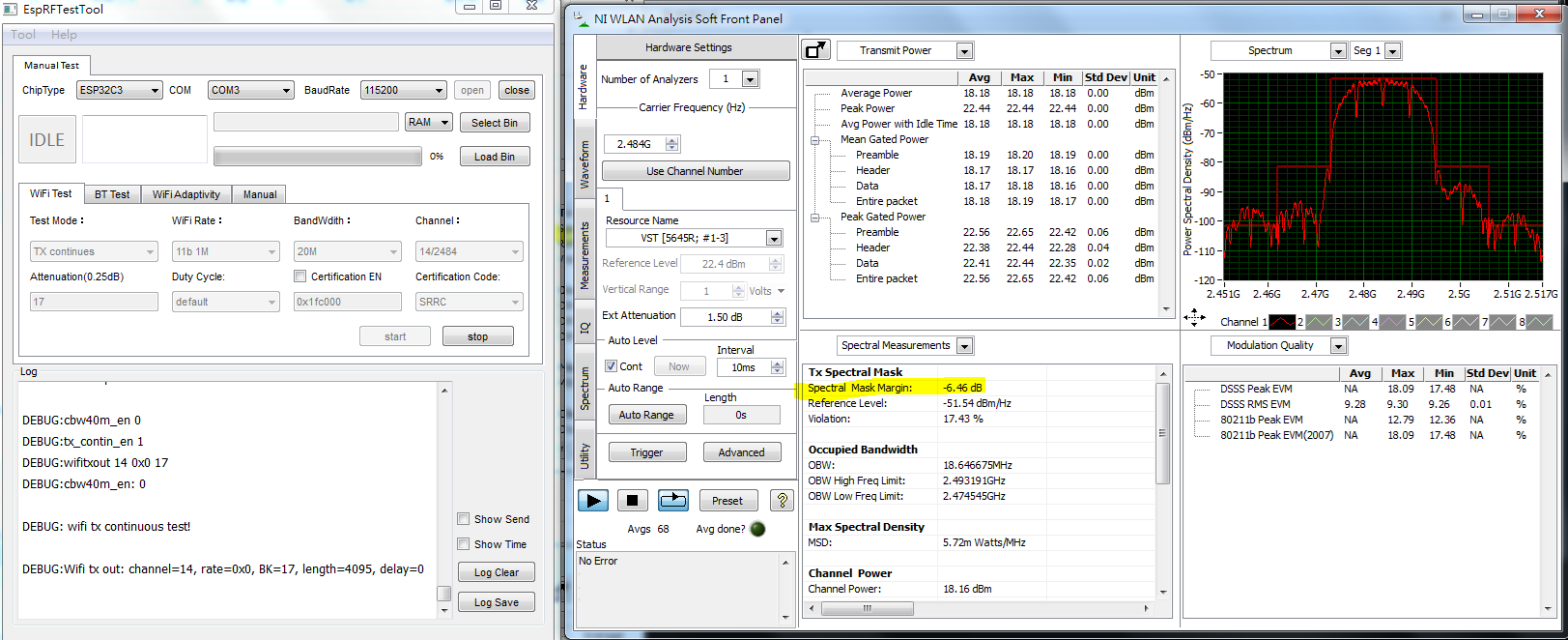

ESP32-C3 wifi tx 11b mask fail
Moderator: Bob
gfjack921
Joined: Wed Aug 04, 2021 5:42 am
Postby gfjack921 » Tue Sep 28, 2021 2:19 am
chip: C3FN4
DUT: 安信可 ESP-C3-13U
Test bin : ESP32-C3_ECO3_RF_TEST_BIN_V104_20210628
我在測wifi tx 11b channel 14 時,在Spectrum 發現Mask 未通過遮罩
大家是否都一樣阿?
TX ERROR.png (194.71 KiB) Viewed 7263 times

Re: ESP32-C3 wifi tx 11b mask fail
Postby Eavo » Wed Oct 13, 2021 10:00 am
您好,RF 性能与匹配参数有关,请咨询模组厂商。谢谢。
