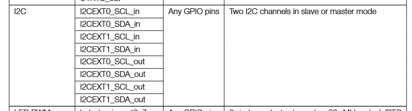

Hello, I would like to know where to find the default configuration for I2C?
Went through all chip/module and board documentation and was not able to find this.
Thanks for your help or hint in advance.

Pins GPIO8 and GPIO9

standard pins are "only pre set" in arduino, you can use any GPIO pin for I2C ( SDA, SCL ) - you find this info under "Peripheral Pin Configurations" in the ESP32-S2 Datasheet example
