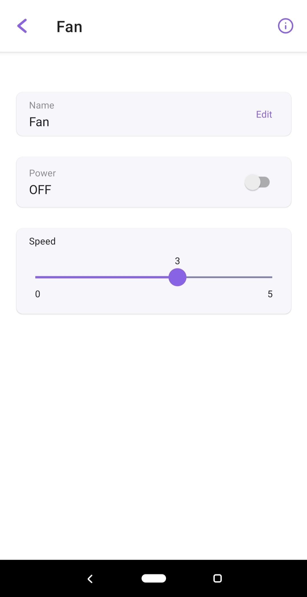

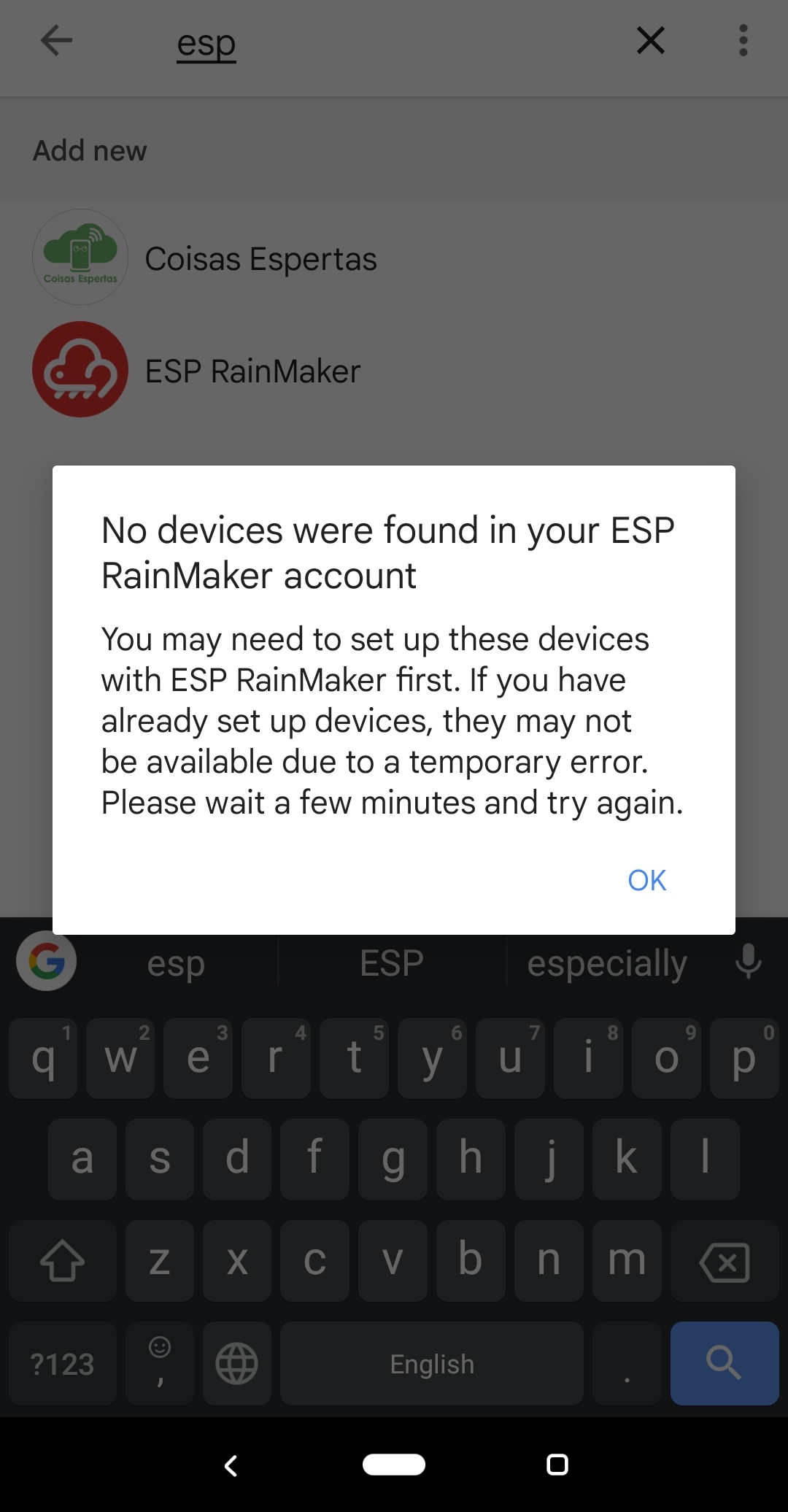

Thank you for responding quickly, I used the same fan example from esp-rainmaker it's just that I have added few thing on that example as per my application requirement, so when I link Esp-rainmaker with google home there pops up a screen saying "No device found on esp-rainmaker" instead my device is already connected to rainmaker and working fine when controlled via rainmaker app and Alexa. Then I tried switch and light_bulb examples to find out the problem with google voice assistant but those examples worked with GVA, can you guide me that why fan program is not working with GVA, below I have attached the screenshots of GVA screen pop up. I am looking forward for help.

- Device setup on rainmaker
- IMG_20210924_120023.jpg (59.5 KiB) Viewed 18098 times
- Message screen of google home
- IMG_20210924_120009.jpg (244.99 KiB) Viewed 18098 times

Re: Parameter mapping to enable GVA controlled device.
After checking internally , I found out that the fan support wasn't pushed out to production because the fan speed control from GVA was not as straightforward as a range controller for Alexa. We will check how this can be supported and add it asap.
