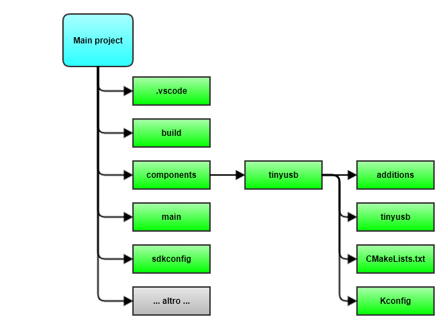

In your project create components folder and uncompress this tinyusb component. It is with required changes and you will be able to use espressif cdc acm example you started with:
tinyusb.zip

Postby filo_gr » Tue Oct 19, 2021 3:33 pm
@chegewara I want to thank you for helping me and for your patience.
There was something missing in my knowledge for completely understand how to do. I read the guide here https://docs.espressif.com/projects/esp ... ystem.html and I understood how ESP-IDF treats the custom components.
I put the files obtaining in the following tree:
Directory tree for custom components.
After that I built and flashed and now it has the correct desciptor's USB parameter! :D
Thank you again, you were really helpful.
Filippo
