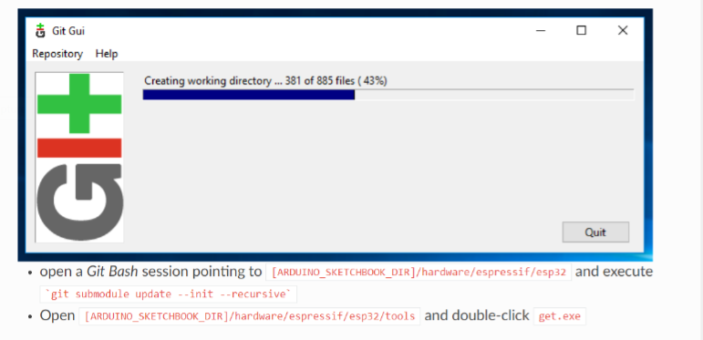

"open a Git Bash session pointing to [ARDUINO_SKETCHBOOK_DIR]/hardware/espressif/esp32 and execute"
When I open Git Bash I see this ;
jpfra@JohnFrancis MINGW64 ~
What does "pointing to" mean? What do I do?
Thank you
Setup instructions; I am stuck here
- 2021-10-24_14-57-38.png (73.22 KiB) Viewed 8094 times

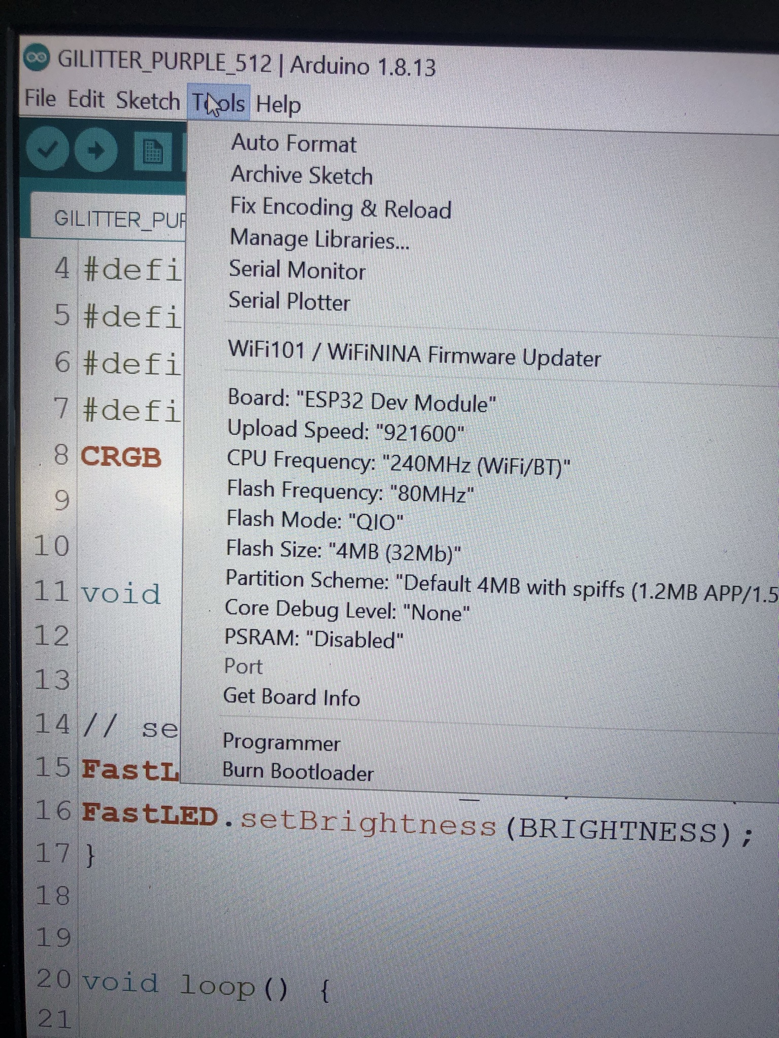

Re: Setup instructions; I am stuck here
IDE ERROR MESSAGE
Arduino: 1.8.13 (Windows 10), Board: "ESP32 Dev Module, Disabled, 8M Flash (3MB APP/1.5MB FAT), 240MHz (WiFi/BT), QIO, 80MHz, 4MB (32Mb), 921600, Core 1, Core 1, None"
Sketch uses 208977 bytes (6%) of program storage space. Maximum is 3342336 bytes.
Global variables use 11832 bytes (3%) of dynamic memory, leaving 315848 bytes for local variables. Maximum is 327680 bytes.
esptool.py v3.1
File "esptool.py", line 4582, in <module>
Serial port COM3
File "esptool.py", line 4575, in _main
File "esptool.py", line 4074, in main
File "esptool.py", line 120, in get_default_connected_device
File "esptool.py", line 313, in __init__
File "serial\__init__.py", line 90, in serial_for_url
File "serial\serialwin32.py", line 64, in open
serial.serialutil.SerialException: could not open port 'COM3': FileNotFoundError(2, 'The system cannot find the file specified.', None, 2)
[31652] Failed to execute script esptool
the selected serial port [31652] Failed to execute script esptool
does not exist or your board is not connected
Board at COM3 is not available
This report would have more information with
"Show verbose output during compilation"
option enabled in File -> Preferences.
esptool.py v3.1
Serial port COM3
johnfrancisbarjols
- Posts: 6
- Joined: Thu Oct 21, 2021 7:52 am

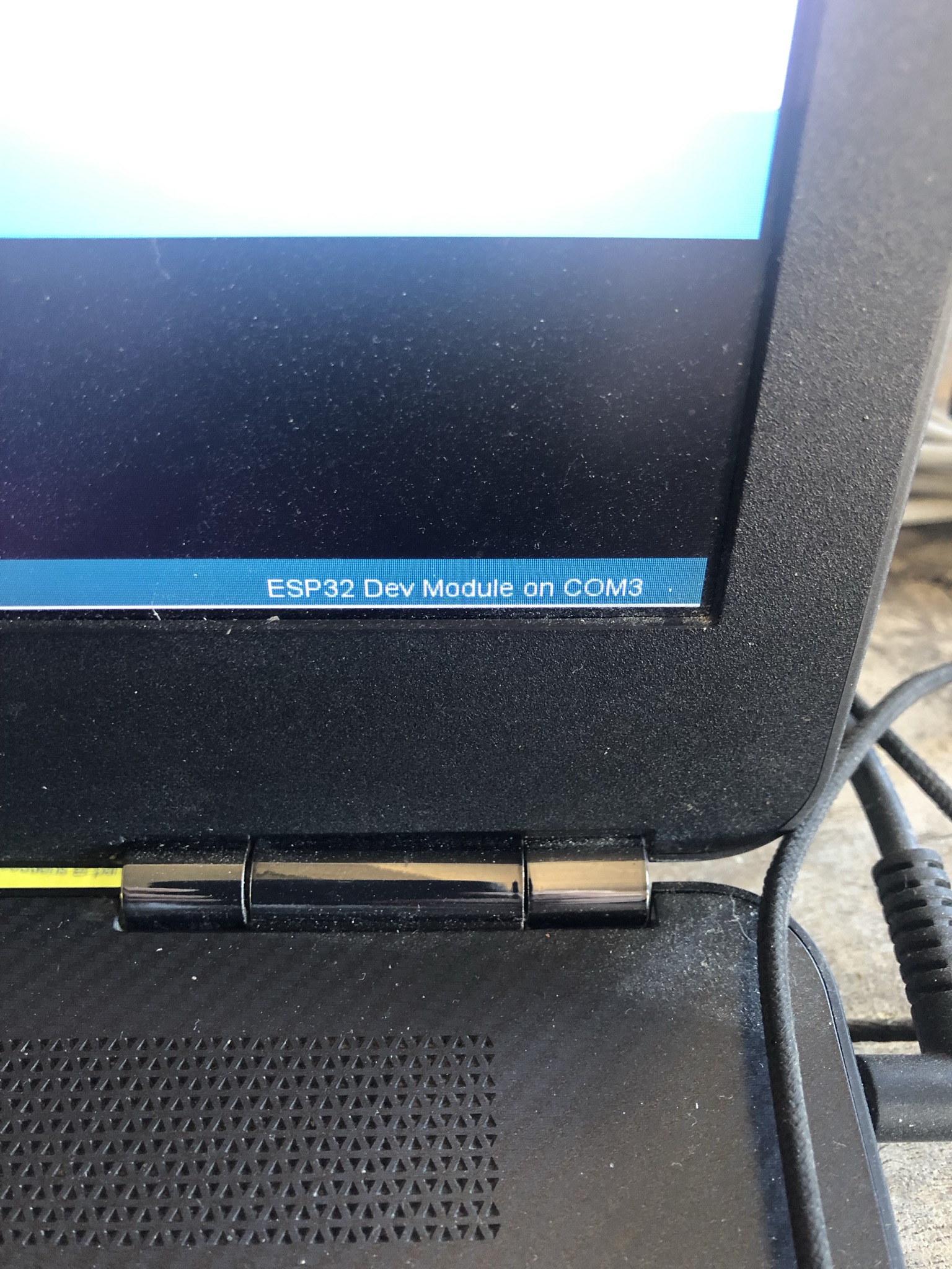

This is the blank port IDE tool menu AND the ESP32 COM3 notification at the right hand side of the IDE window:
ATTACHED
ATTACHED
- IMG_4343.JPEG (1.5 MiB) Viewed 7925 times
- IMG_4342.JPEG (802.62 KiB) Viewed 7925 times
lbernstone
- Posts: 1138
Why not use the board manager (the recommended method) to install?
https://docs.espressif.com/projects/ard ... l#hardware
