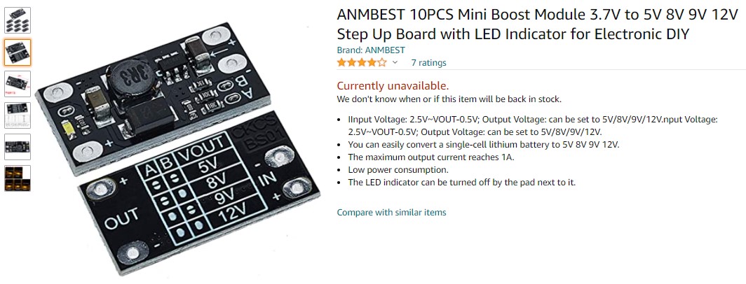

The current I measured from the booster to the sender node was 0.2 A. Is this enough?
I soldered the pads next to A and B, as the instructions said, to get 5V output on the booster. I don't think there's an enable pin.
This is the booster I am using:
- booster.jpg (106.55 KiB) Viewed 6389 times

Sorry, correction to this part:
Its supposed to be "I broke apart the pads next to A and B using a soldering iron, as the instructions said, to get 5V output on the booster."I soldered the pads next to A and B, as the instructions said, to get 5V output on the booster.

Are you using lipo with a protectionboard?
Otherwise your lipo meight get damaged since there is no undervoltage protection.
Accoding to your screenshot this booster should be able to deliver 1A max so, 0.2A shouln't be a problem. Altough I would expect the output of this booster to have a very diry signal. Also, specs on websites like aliexpress shouldn't taken to seriousely.
To be fair, I would suggest you to use another booster board, something a bit more suitable to your application. You could buy one of those cheap usb charger things that use one lipo cell.

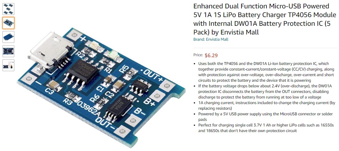

No, I'm not using any protection board. Is that any different from a charging module/board like the screenshot below?
Do you know any good booster board that could (hopefully) work on the sender node?
I did think of buying a cheap 2600 mah powerbank to power the receiver node if I can't make it work using a booster since it worked when I plugged it to my powerbank.

The board in your last post has a protection circuit. So that is more suitable for you.
Altough its better suited, im not sure if it will fix your initial problem.
