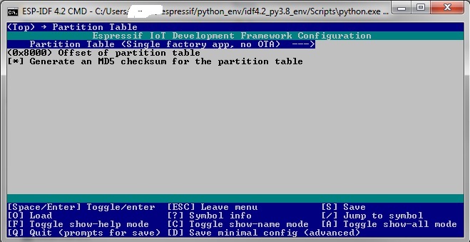

Has anybody used the sample project: i2s_adc_dac?
I want to try it out, but after successful compiling,
When I run it, comes with an error: ad/da: Partition error: can't find partition name: storage.
What do I need to do to make it work?
I have thought that sample projects are there so you can use them straight away and see some results, not throwing another error.
Can anybody help me?
Thanks,

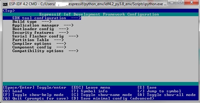

tommeyers has pointed me to a page that does not explain me how to do it,
or better said it tells me how to do this:
Creating Custom Tables
If you choose “Custom partition table CSV” in menuconfig
but there's no such thing as “Custom partition table CSV” in menuconfig
and he's telling me to Check the readme file here, but he doesn't tell me where "here" is. It could be inside his house, I don't know.
can someone else who actually knows how to create a partition help me, please?
Thanks,
Regards.
Victoria Nope
Posts: 75
Joined: Fri Dec 04, 2020 9:56 pm
Re: i2s_adc_dac
Postby Victoria Nope » Fri Nov 05, 2021 12:13 am
I guess he meant the example's readme (specifically this paragraph, I'd say).
If so, it turns you to the same menu item that you've already discovered but could not find. I don't have IDF by hand and what's even worse, I'm not a user of this tool (it's so DOSy for me), but I bet you can change the partition table definition source by just pressing ENTER on that Partition Table (Single factory app, no OTA) - - - > menu item and select Custom partition table CSV in its submenu as it seems that the - - - > symbol stands for submenu.
But it's just a guess based on reading menu structure from the component itself (IDF v4.2).

Thank you very much Victoria Nope
With your kind explanations I've been able to figure out my problem, and now my esp is playing back an audio file.
Many thanks again Victoria Nope
