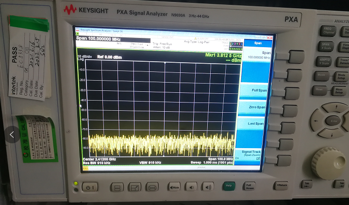

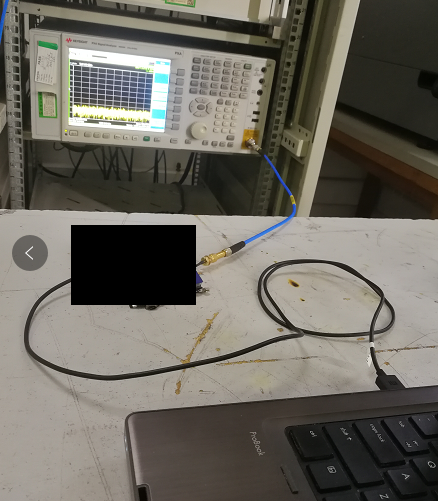

We recently sent a few custom-designed devices based on ESP32 Pico D4 to a test lab for CE Compliance testing. There they informed me that the devices are not Txing on 2.4GHz WiFi band.
I had sent them the ESP RF Test tool v2.5 back then. I also tried to replicate the scenario but with crappy monitoring tools like SDRs and WiFi analyzer apps since I do not have access to a Spectrum analyzer. I too realized that the devices are not really Txing.

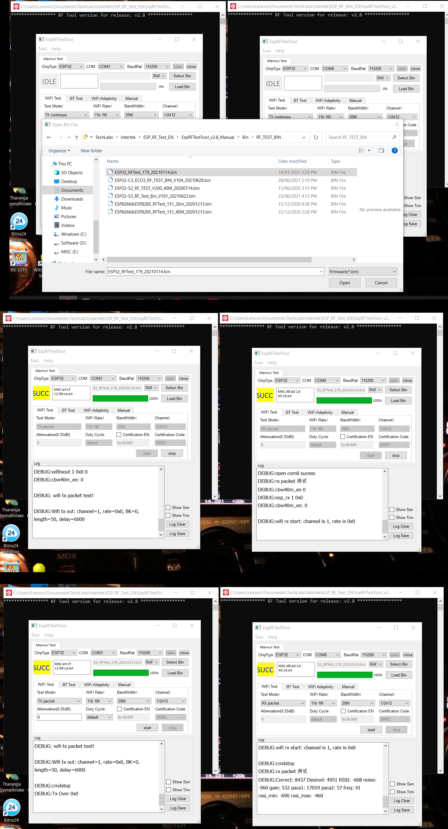

Now I am doing the same test using ESP RF Test tool v2.8 running with two dev boards. (One based on ESP WROOM 32 and the other on PICO D4). The result is still the same no matter if I load it into RAM or Flash. What am I doing wrong here? [*]Aren't they supposed to show the Tx and RX Packets on the logs?
[*]Is the RF Test tool made for a specific chip variant only?
The test lab wants to Tx on different channels with different power levels. Any help would be much appreciated.

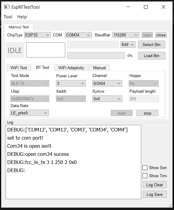

We have exactly the same issue, but with the BLE TX test.
We have a product based on ESP32-PICO-D4 that's undergoing a RF certification process. We sent it to the test lab with the RF Test firmware on it (RFTestBIN 179), along with a link to download ESP RF Test Tool v2.8.
The lab informed us that they start the BLE TX test, but there is "no transmission signal present". These are their settings:
I don't have access to a signal analyzer and cannot confirm the absence of a signal myself. The hardware itself works as expected with its "normal" firmware, so this problem is pretty strange. Can somebody provide any assistance?
Thank you in advance.
(sorry for the huge screenshot).
