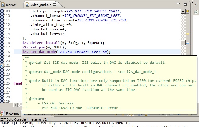

But what rudi says, i get a compiler error when enabling audio and when i remove the I2C ENABLE DAC line it compiles fine but with no audio.
Is that command something that has'nt been added to esp-idf yet?
Posts: 1756
Re: esp32 nes code segmentation error
Postby rudi ;-) » Fri May 12, 2017 1:30 pm
thanks! it works
thanks for testing audio if you remove I2C enable DAC line and audio is not working :)
so i need not to test this way - i think we must wait for the update on esp-idf for the future work on I2S Enable DAC ,
seams Jeroen used future code that is just in time not available like he described in preview text.

ESP-IDF 2.0 Release online
I2S PDM support
last but not least - now it compiles :)
