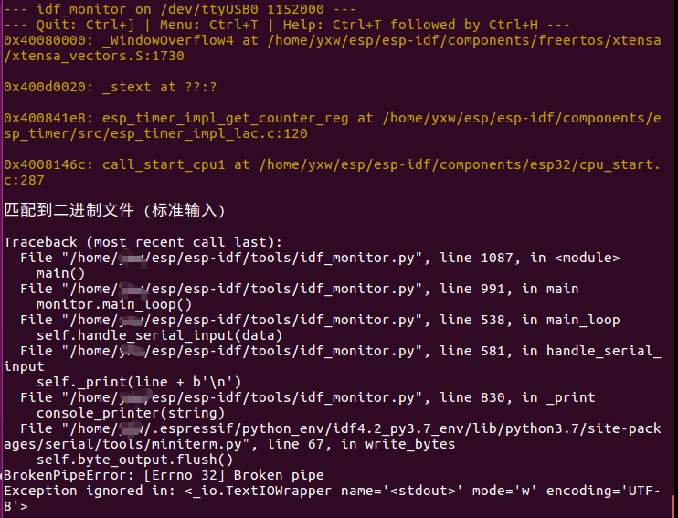

**Describe the bug
When using the command:idf.py -p /dev/ttyUSB0 monitor | grep "CSI_DATA" > my-experiment-file.csv ,there is a error:BrokenPipeError: [Errno 32] Broken pipe

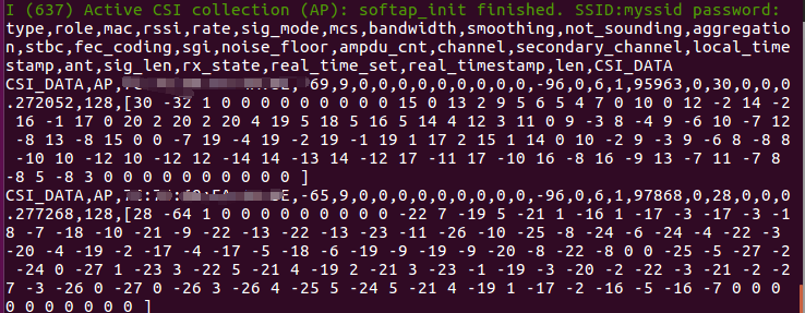

4.use the commond :idf.py -p /dev/ttyUSB0 monitor ,then let my phone connect to the AP,it can collect CSI successfully.

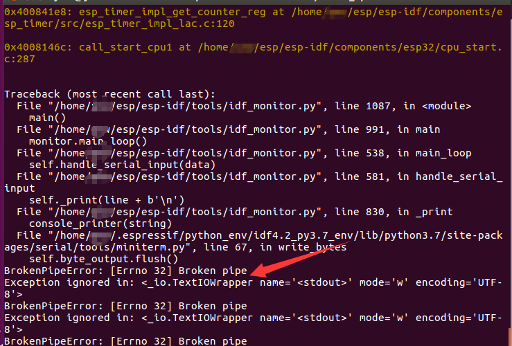

5.use the commond:idf.py -p /dev/ttyUSB0 monitor | grep "CSI_DATA" , let my phone connect to the AP, then it printed the error like this :
6.use the commond:idf.py -p /dev/ttyUSB0 monitor | grep "CSI_DATA" > my-experiment-file.csv , let my phone connect to the AP, then it printed the error like this :

Re: When exporting datas:BrokenPipeError: [Errno 32] Broken pipe #40
Postby Sprite » Sat Nov 13, 2021 5:36 am
The monitor is intended to run interactively, that is, without its output redirected. As a workaround, you can use ctrl-L in a monitor session to copy the output to a log-file, then after you're done, grep that log file for your data.
