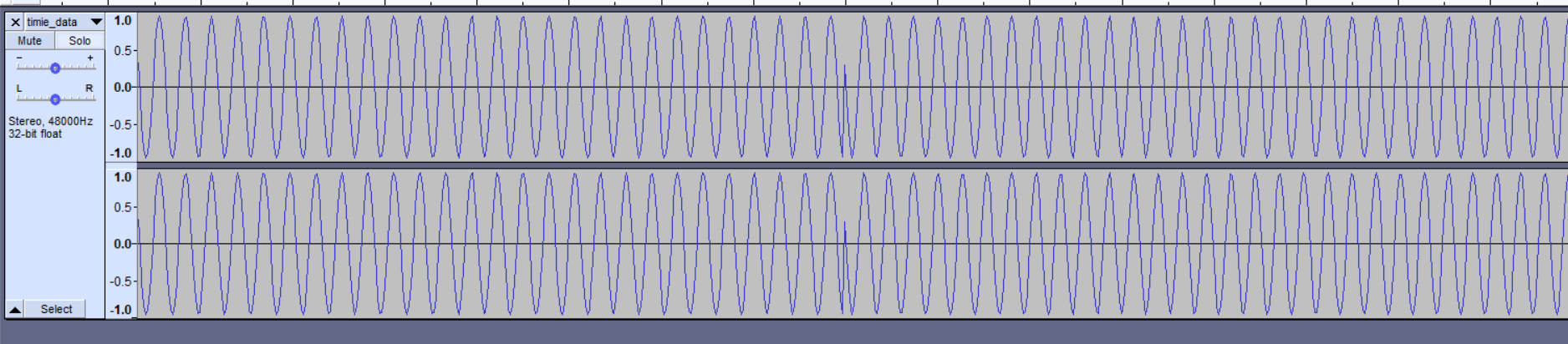

Dear L-KAYA,
I have the result of your provided code. I did not change anything in your configuration. However, still I am getting missing sample in data.
Following are the log message from my device.

i2s_read block time: 7862 us
i2s_read block time: 11607 us
i2s_read block time: 12259 us
i2s_read block time: 23 us
i2s_read block time: 21 us
i2s_read block time: 103 us
i2s_read block time: 22 us
i2s_read block time: 102 us
I (1258) rap_adc: Recording done!
I (1259) rap_adc: File written on SDCard

Hi shailesh.korat,
Glad to see you!
For the first question, here is the explanation for overtime_tick:
Meaning
1. Generally speaking, 'overtime_tick' is the ticks that 'i2s_read' should cost, that means, if the i2s_read task wait for more than 'overtime_tick', there must be data dropped.
2. 'overtime_tick' can also be treat as 'i2s_read' blocking time when there is no data lost.
Calculation
1. Since we have knew the channel number and the bits in one channel, then we can calculate the total bytes in one frame is:
frame_bytes = chan_num * bits_per_sample / 8
2. Then we can know the how many bytes there will be in one second (i.e. byte rate)
byte_rate = frame_bytes * sample_rate
3. Finally we can get the time for receiving EXAMPLE_RECV_BUF_SIZE will cost:
recv_time = EXAMPLE_RECV_BUF_SIZE / byte_rate
4. Transfer to miliseconds
overtime_tick = recv_time * 1000
For the test result,
I notice that i2s_read block time is short. In the normal case, the block time should always be around 'recv_time' that mentioned above, that means the received data are taken from message queue immediately, the queue is always empty, i2s_read has to keep waiting for the data from message queue until the receive buffer is filled up. So no data will be dropped, and the 'recv_time' is equal to 'i2s_read' block time. But when the i2s_read block time is short, it means the message queue is always full, so that i2s_read can get data immediately from message queue without any block. Since the data in message queue can't be taken timely, the old data will be dropped to input new data, then you can see the data lost.
I see your wave looks much better after allocating a bigger receive buffer, my suggestion is keeping increase the receive buffer, a big buffer should always help.

A2: Yes, your method is right, but this is a bug, it will be fixed together with the update of programming guide, then you can catch the overflow event.
A3: From my understanding, the slower you process the data, the bigger buffer you need. So I think it is mainly depends on the complexity rather than the limitation of IDF.
A4: Partly right. Although the message queue will overflow if i2s_read not called, it can still be taken to underflow as long as the speed of i2s_read is faster than receive. Otherwise, the message queue will always be overflow if the speed of i2s_read can't catch the speed of data receiving from ISR.
A5: If you want to read 192 samples for one-time i2s_read, firstly you should allocate a 1536 bytes buffer for reading. Secondly, dma_buf_len should be smaller than 192, smaller than 192/2 = 96 will be better, here is the reason:
If the dma buffer size is greater than the user given buffer size, it means we need several loops of i2s_read to take all the data in one dma buffer, the max_wait_time will be squeezed to avoid message queue overflow. Therefore it is quite risky to give a small buffer for data receiving when calling i2s_read.
