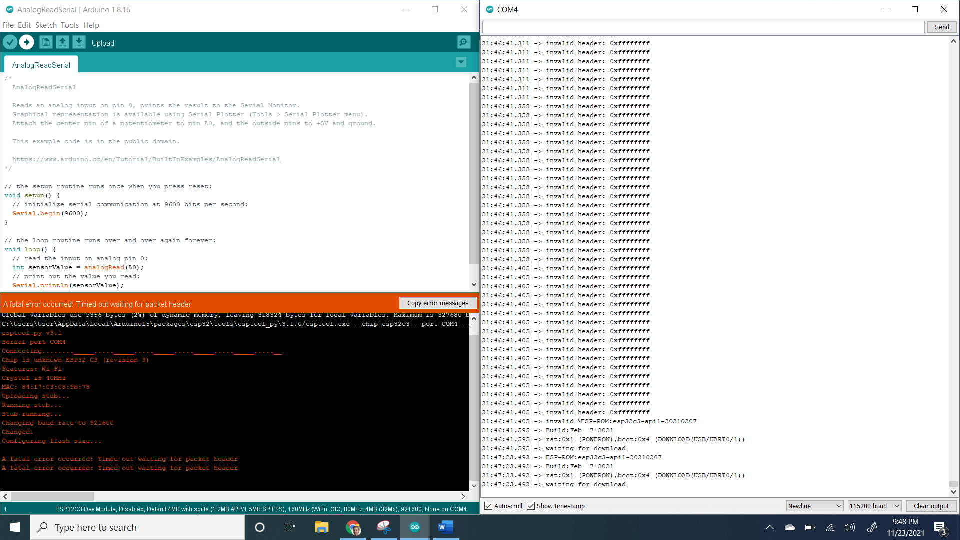

A symptom I saw that indicated I had to try another programming chip was that the esp32 took a long time to connect (....._____......____) see attached picture.
Esp32 Error Message.png (193.25 KiB) Viewed 16304 times
