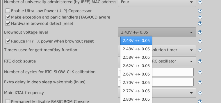

Where are defined brownout voltage level on esp-idf ?
Is it possible to change the default values ? Only for test purpose
Immagine 2021-12-12 105051.png (56.65 KiB) Viewed 5255 times
The level is defined by the CONFIG_ESP32_BROWNOUT_DET_LVL_SEL project configuration option.
No, because the voltage levels are fixed in HW by enumeration values of the RTC_CNTL_DBROWN_OUT_THRES register. See page 718 of the reference manual.
