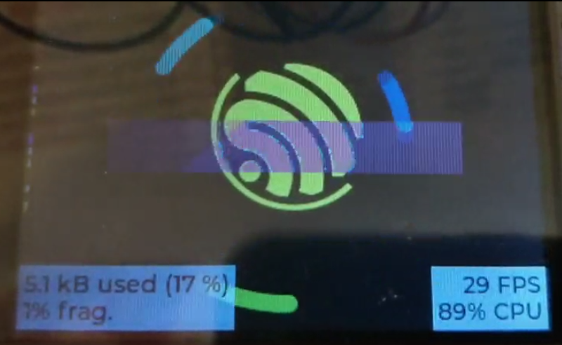

Postby stwirth » Tue Dec 21, 2021 1:01 pm
I have hooked up an ILI9341 to an ESP32S3 using the Intel 8080 interface, following the example at https://github.com/espressif/esp-idf/tr ... s/lcd/lvgl
When the screen animation is running, I see some artifacts occasionally.
When I additionally initialize an i2s interface (using esp-adf) with
  i2s_stream_cfg_t i2s_cfg = I2S_STREAM_CFG_DEFAULT();
  i2s_cfg.type = AUDIO_STREAM_WRITER;
  audio_element_handle_t i2s_writer = i2s_stream_init(&i2s_cfg);
then the artifacts become much more frequent.
The artifacts seem to flash for a single frame in the area that gets re-drawn during animation. I have attached an example.
Any hints on what settings I could investigate or how to debug this further are greatly appreciated.
Thanks,

Postby Sprite » Wed Dec 22, 2021 2:36 am
Possibly corruption in your clock/data lines. You could try to lower the clock speed to your LCD.

Postby stwirth » Wed Dec 22, 2021 9:36 am
Awesome, thanks!
Lowering pclk_hz from 10M to 5M solved it!
