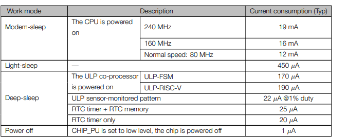

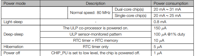

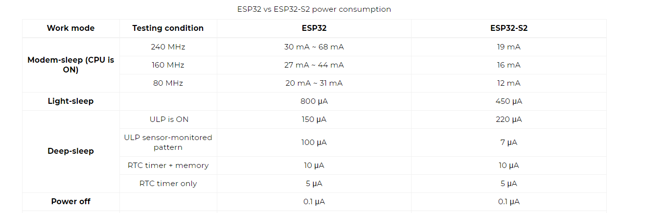

Hello, as i want to build a battery powered application, with a long deep sleep time, i want to use an esp32-s2. However in the Datasheet it states, that it has a 4 times higher deep sleep current(20ua), than the "normal" esp32(5ua). Then on the internet i find a chart, where it states both consume only 5ua(See Attachements). What is right and if the Esp32-s2 has a 4 times higher Deep Sleep current: why?

The information you found is correct, indeed ESP32-S2 chips available now have higher deep sleep current than the ESP32.
In the future there may be a new revision of ESP32-S2 silicon that improves the deep sleep current consumption, but it's not determined yet whether/when it will be made. For the time being, 20uA is the number you can expect.
