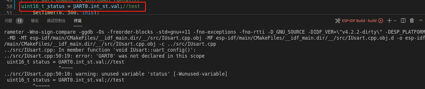

I have the same problem. ESP32-S2 IDFV4.2.2

That is not the same error. Please use a separate post for this.
