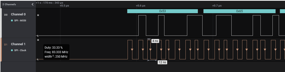

Hello im trying to test the SPI speed with a loop between the MISO and MOSI pin.
To get a fast entry point i used the \examples\peripherals\spi_slave\sender project.
I changed the pins to the VSPI iomux pins so can still debug.
My Problem is now i can only go up to 26 mhz instead of up to 80 Mhz like the ref man api ref and datasheet r telling is the max Speed for SPI master.
My hardware is the https://docs.espressif.com/projects/esp ... it-v3.html
1. cant setup 80 Mhz for clock speed than the rxbuffer has the wrong data inside
2. i recognized that the dutycycle is not 50/50 its more 30/70 see logicAnalyzer screenshot in the attachments(ok solved this it was bc logic analyzers Sample rate was to low with an oszi it was good)
Would be very nice if someone can have a look and help me.

Ah, sorry, I did not spot that you used the dedicated VSPI pins. What corruption do you get when you try the example at 80MHz? Also note that wiring at those speeds becomes important: if you're using a breadboard you want a wire as short as possible between MISO and MOSI, for instance.

What is the logic analyzer you are using and what sampling freq are you using?

ok thank you guys for helping esp spirit is right i used a to long cabble to loop the signal that made some problems and i setup the spi now with input delay of 50 ns and set the flag SPI_DEVICE_NO_DUMMY with this setup i can run up to 80 Mhz
always never forget rule #1 read from top to bottom
but maybe someone will find it and it helps him xD
@chegewara I m using a salea Logic Pro 8 normaly but when its going real fast i use a Rohde&Schwarz Ozci
