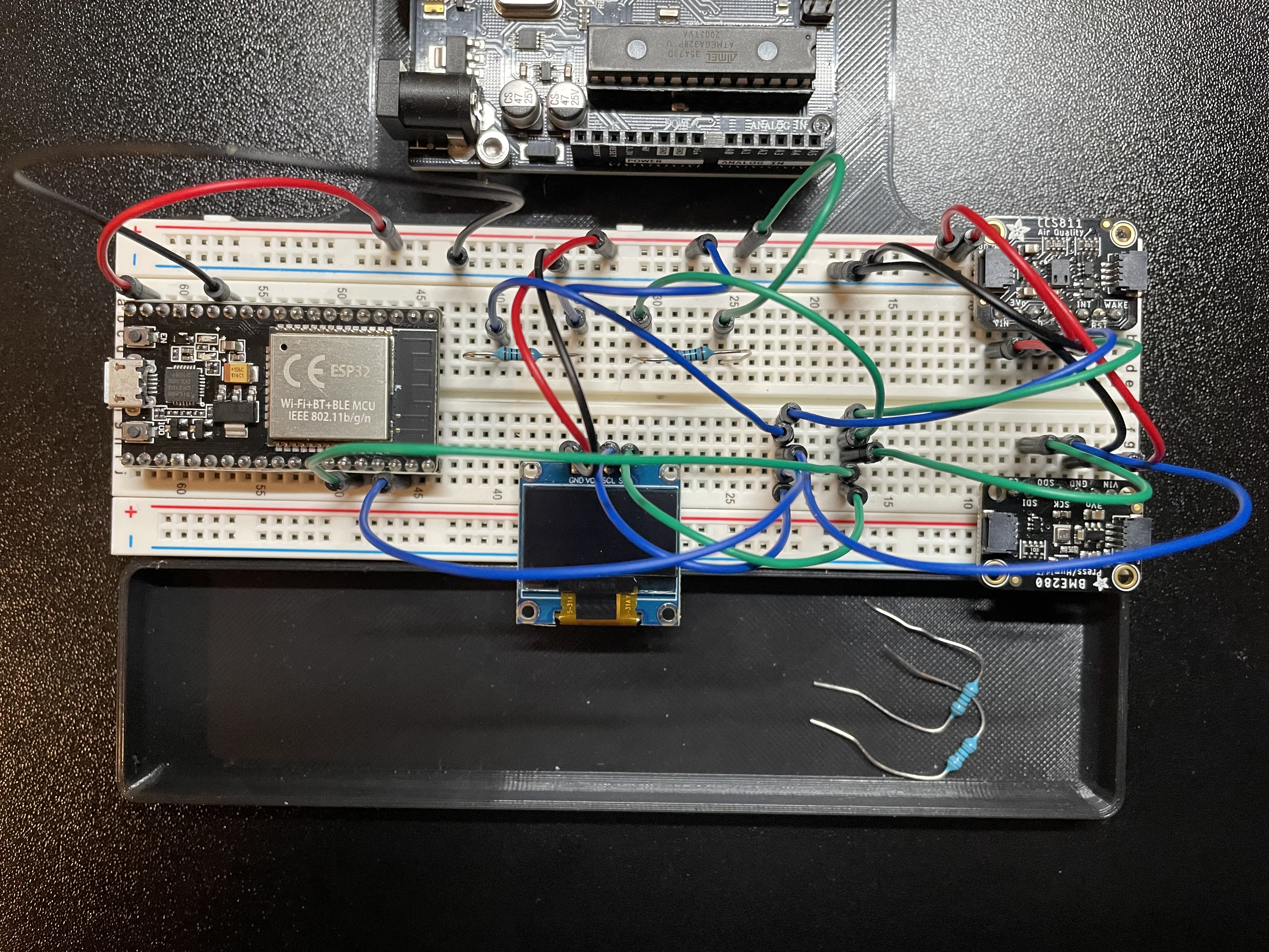

I am working on an indoor air sensor station with 2 air sensors:
Adafruit BME280
Adafriut CCS811
I also have an OLED screen I am using to display the data from the sensors. All on the same I2C bus.
I started by hooking everything up to an Elegoo UNO to get my code running and make sure the sensors worked and I got that working great. But now that I have transitioned to the ESP32 the board will not recognize the I2C devises on the bus.
I ran the I2C scan example sketch and it finds 2 of the 3 devices on the line, the BME280, and the OLED. But it will not see the CCS811.

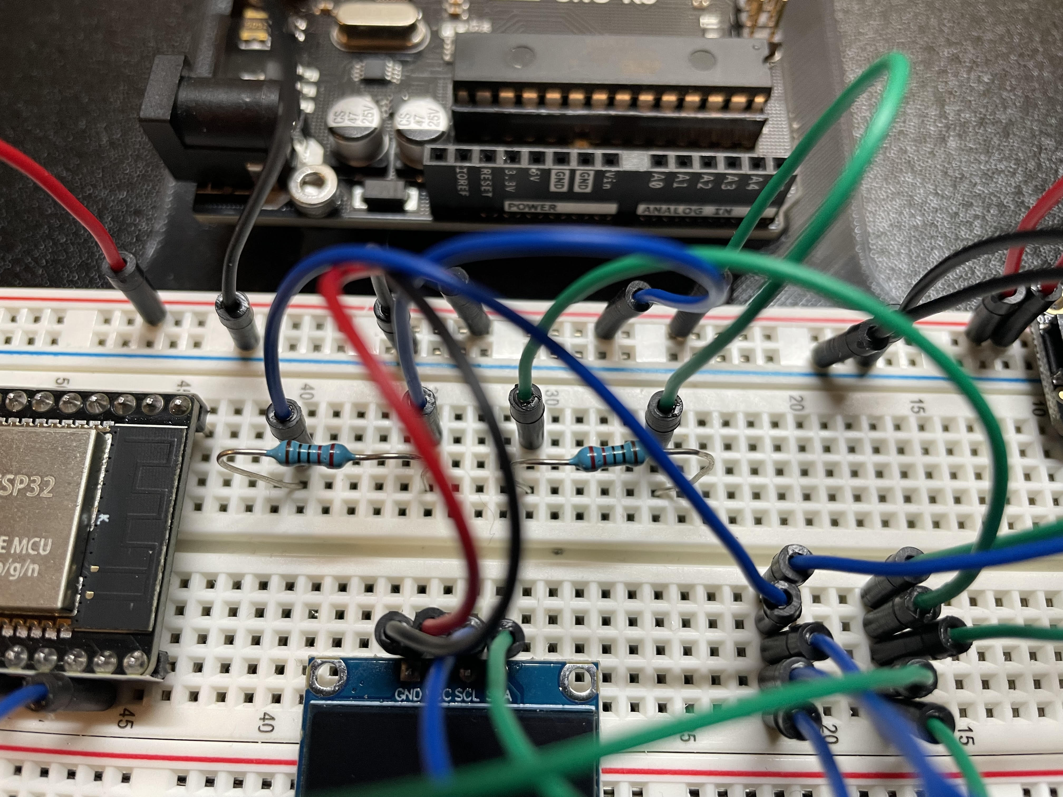

At first I thought it was the lack of a Pull up Resistor as I did not have them when I wired the sensors to the UNO. So I added a 1K resistor to the bus on both the clock and data lines going to the 5V. But that seems to have made no difference.
I am sure it's something stupid that I am missing as this is my first project and I am a NOOB at this, any help would be great thanks a lot for your help. Here are some pictures and diagrams with code.

Postby LJH » Thu Feb 10, 2022 3:48 am
Have you measured I2C signals from oscilloscope or logic analyzer?
And since ESP32 only supports up to 3.6 V, could you make sure I2C lines are 3.3 V interface then have a try?

Postby MikeLemon » Tue Feb 22, 2022 7:33 am
After checking the hardware interface physically try testing with an I2C scanner code which can commonly be found on the internet especially for Arduino platform that'll help you see if your SDA and SCL lines are not swapped.
after this check's I'd generally recommend running a know to work example code to test the hardware.
