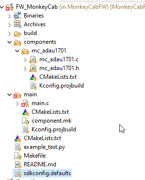

And we added an own component to that project like this:
so the component itself uses i2c so I added following lines to CMakeLists.txt:
[Codebox]
idf_component_register(SRCS "mc_adau1701.c"
INCLUDE_DIRS "."
REQUIRES driver)
[/Codebox]

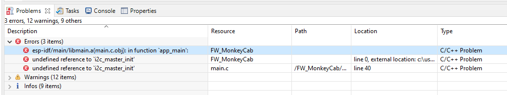

Editor shows no errors or mistakes, but on compile time, we get this error message, that the function in our project is not found:
Are we missing something? Is there any thing more to to to tell CMake that there is a component?

Got it... was my own fault.
I tried to reference a static function :mrgreen: :lol: :oops:
Move along - nothing to see here. :mrgreen:
