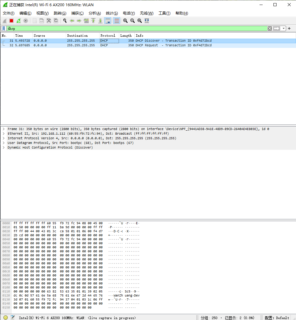

使用 IDF wifi station 示例(examples/wifi/getting_started/station)也拿不到 IP?是只有这个路由器拿不到 IP 还是都拿不到 IP?换个模组能否拿到 IP?
之前连这个路由器都能正常获取ip的,从上周起开始出问题了,估计重启路由器能正常,但是不想破坏环境想搞清楚。
YJM
Posts: 304
Joined: Fri Feb 26, 2021 10:30 am
Re: ESP32 DHCP 获取不到IP
Postby YJM » Tue Mar 01, 2022 8:11 am
你抓取 wifi 包,把模组重启,然后把 log 和抓包发过来。
liutao
Posts: 24
Joined: Fri Feb 25, 2022 3:11 am
Postby liutao » Tue Mar 01, 2022 8:18 am

dhcp_start(netif=0x3fca175c) st1
dhcp_start(): restarting DHCP configuration
dhcp_start(): starting DHCP configuration
udp_bind(ipaddr = 0.0.0.0, port = 68)
udp_bind: bound to 0.0.0.0, port 68)
udp_connect: connected to 0.0.0.0, port 67)
dhcp_discover()
dhcp_discover(): dhcp state is DISCOVER
dhcp_select: could not allocate DHCP request
transaction id xid(a53ff519)
dhcp_discover: making request
dhcp_discover: sendto(DISCOVER, IP_ADDR_BROADCAST, LWIP_IANA_PORT_DHCP_SERVER)
udp_send: added header in given pbuf 0x3fc9d3b4
udp_send: sending datagram of length 316

Postby liutao » Tue Mar 01, 2022 9:10 am
这个只是有线包,不是无线包。现在需要抓取无线包看模组有没有发送成功或者路由器有没有回复。
我选的是无线网卡 AX200
第17秒我打开手机连wifi能捕获手机的DHCP Discover,但是从来没有捕获到过ESP32C3的DHCP Discover。
DHCP_17秒手机开始获取.txt
(114 KiB) Downloaded 1353 times
电脑热点.txt
(4.93 KiB) Downloaded 1169 times
用电脑共享wifi能捕获到。

Postby liutao » Tue Mar 01, 2022 9:50 am

dhcp_discover: deleting()ing
dhcp_discover: SELECTING
dhcp_discover(): set request timeout 500 msecs
W (787) wifi:<ba-add>idx:0 (ifx:0, 9c:a6:15:29:e3:57), tid:0, ssn:0, winSize:64
I (797) BLUFI_EXAMPLE: WIFI_EVENT_STA_CONNECTED
ip_input: iphdr->dest 0x7001a8c0 netif->ip_addr 0x0 (0x0, 0x0, 0x7001a8c0)
ip_input: iphdr->dest 0x7001a8c0 netif->ip_addr 0x100007f (0xc0, 0x7f, 0x7001a800)
ip4_input: UDP packet to DHCP client port 68
ip4_input: DHCP packet accepted.
ip4_input:
IP header:
| 4 | 5 |  0x00 |       576     | (v, hl, tos, len)
|      130      |010|       0   | (id, flags, offset)
|   64  |   17  |    0xb469     | (ttl, proto, chksum)
|  192  |  168  |    1  |    1  | (src)
|  192  |  168  |    1  |  112  | (dest)
ip4_input: p->len 576 p->tot_len 576
udp_input: received datagram of length 556
UDP header:
|        67     |        68     | (src port, dest port)
|       556     |     0x77b7    | (len, chksum)
udp (192.168.1.112, 68) <-- (192.168.1.1, 67)
pcb (0.0.0.0, 68) <-- (0.0.0.0, 67)
udp_input: calculating checksum
dhcp_recv(pbuf = 0x3fcaa220) from DHCP server 192.168.1.1 port 67
pbuf->len = 548
pbuf->tot_len = 548
searching DHCP_OPTION_MESSAGE_TYPE
DHCP_OFFER received in DHCP_STATE_SELECTING state
dhcp_handle_offer(netif=0x3fca1d70) st1
dhcp_handle_offer(): server 0x0101a8c0
dhcp_handle_offer(): offer for 0x7001a8c0
dhcp_select(netif=0x3fca1d70) st1
dhcp_select(): dhcp state is REQUESTING
transaction id xid(f4d72bcd)
udp_send: added header in given pbuf 0x3fcb76fc
udp_send: UDP packet length 316
udp_send: UDP checksum 0x3d2d
udp_send: ip_output_if (,,,,0x11,)
ip4_output_if: st1
IP header:
| 4 | 5 |  0x00 |       336     | (v, hl, tos, len)
|        1      |000|       0   | (id, flags, offset)
|  255  |   17  |    0xba9c     | (ttl, proto, chksum)
|    0  |    0  |    0  |    0  | (src)
|  255  |  255  |  255  |  255  | (dest)
ip4_output_if: call netif->output()
dhcp_select: REQUESTING
dhcp_select(): set request timeout 2000 msecs
ip_input: iphdr->dest 0xff01a8c0 netif->ip_addr 0x0 (0x0, 0x0, 0xff01a8c0)
ip_input: iphdr->dest 0xff01a8c0 netif->ip_addr 0x100007f (0xc0, 0x7f, 0xff01a800)
ip4_input: UDP packet to DHCP client port 5001
ip4_input: packet not for us.
ip4_input:
IP header:
|      131      |010|       0   | (id, flags, offset)
|   64  |   17  |    0xb468     | (ttl, proto, chksum)
UDP header:
|       556     |     0x63b7    | (len, chksum)
pbuf->len = 548
pbuf->tot_len = 548
DHCP_ACK received
dhcp_check(netif=0x3fca1d70) st
dhcp_check(): dhcp state is CHECKING
dhcp_check(): set request timeout 500 msecs

在另一个路由器下能捕获到ESP32C3的DHCP Discover,能获取到IP
另一个路由器下.txt
(134.68 KiB) Downloaded 1176 times
YJM
Posts: 304
Postby YJM » Tue Mar 01, 2022 11:37 am
你抓的包只是以太网的包,至于可以抓到是因为你的无线网卡AX200 和这些设备在一个局域网,而 DHCP discovery 包是广播包,局域网的设备是都可以接收到的。至于你使用 ESP32C3 连接路由器,无线网卡没有收到 discovery 的包可能是 ESP32C3 和路由器 WIFI 连接异常,ESP32C3 发送的包路由器没有收到。至于为何没有收到,这可能只能抓 ESP32C3 和路由器之间 WIFI 包,查看 WIFI 连接过程和 ESP32C3 发包情况。
liutao
Posts: 24
Postby liutao » Tue Mar 01, 2022 1:25 pm
那该如何抓ESP32C3 和路由器之间 WIFI 包
我这里有这些
liutao
Posts: 24
Postby liutao » Wed Mar 02, 2022 1:27 am
是要用OmniPeek抓包吗,我去淘宝买个
YJM
Posts: 304
Postby YJM » Wed Mar 02, 2022 2:12 am
是的,用 omnipeek 抓。
