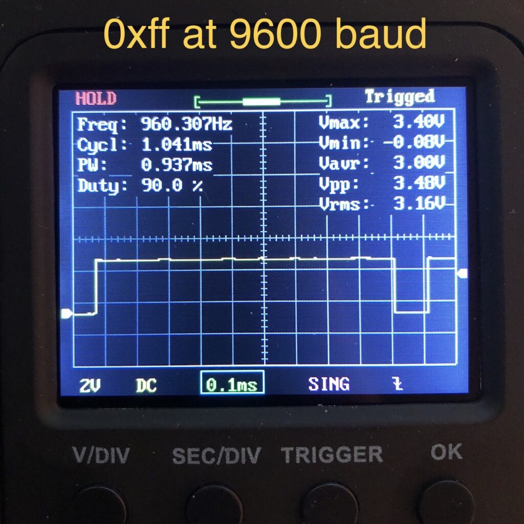

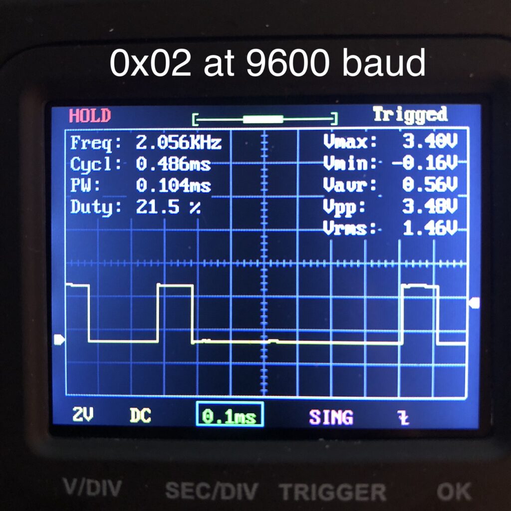

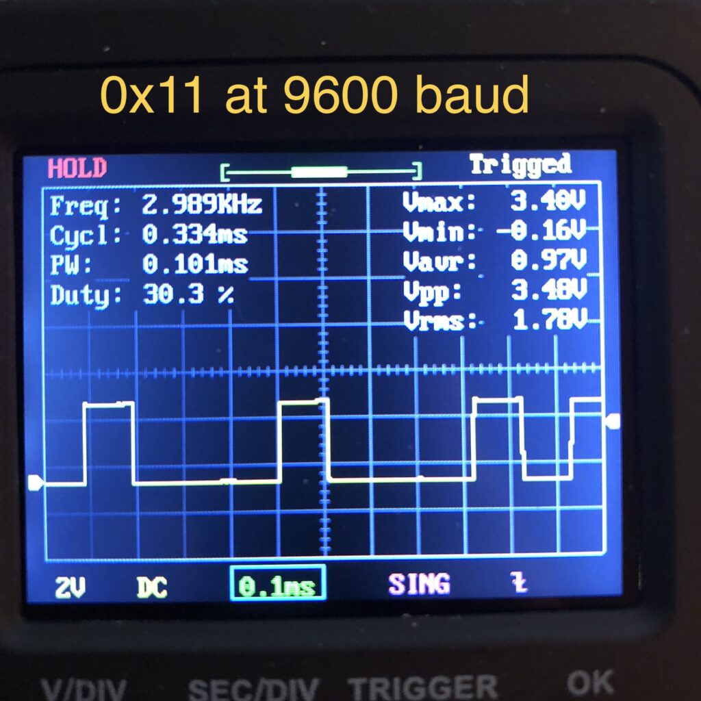

I put the ESP32 on a cheap oscilloscope and it seems to be sending correct data. I suspect that something is wrong with my usb-serial cable. I will update if I find anything.
