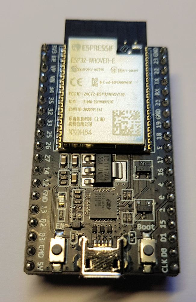

I have received a "ESP32-DEVKITC-VE" like this one: https://www.tme.eu/fr/details/esp32-dev ... espressif/
and I am looking for a development shield that ease with the debugging, I mean something like this: https://fr.aliexpress.com/item/1005003309403141.html
My problem is there are many boards available and many modules, so I am looking for one compatible with my ESP32-DEVKITC-VE.
My board has 19 pins on each side, and the distance between the pins alignment is 25mm: see the attached image.
I have seen that other ESP modules such as the ESP32-WROOM modules only have 18 pins on each side, so I suppose that the development shield are not compatible... what a mess for a newbye in the ESP32 world like me!
Can you tell what shield I should buy ? (preferably from Aliexpress or banggood because I live in Europe)

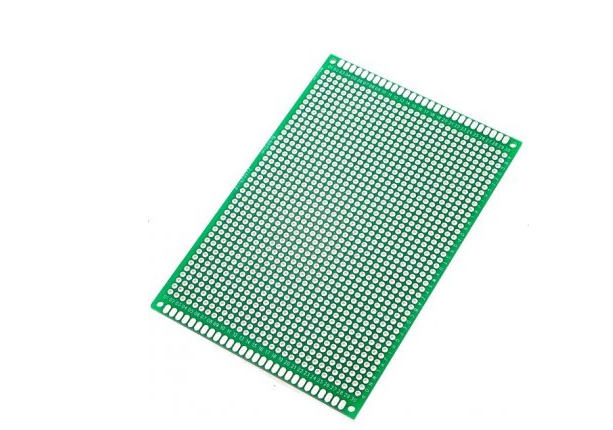

I'm old school and I like things like this.
Screenshot from 2022-03-26 09-11-13.png (247.12 KiB) Viewed 4514 times
