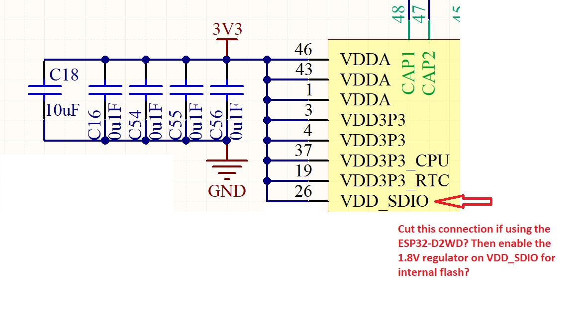

Yes, it is eprfectlky capable of working on 3.3V (and actually will not work when fed with only 1.8V). The internal flash chip, however, is an 1.8V part. In order to generate the power supply for that, the ESP32 has an internal LDO to generate 1.8V from its 3.3V power supply. However, this power supply is configured on bootup, mainly from the state of the MTDI pin: if this pin is high, the power supply will output 1.8V, if it is low, it will pass through the 3.3V chip power supply.
All in all, your PCB will work just fine *if* you made sure that the ESP32s MTDI pin always has a high signal level on bootup.

Can someone comment if the internal flash in the ESP32-D2WD is able to handle 3.3V or what is needed to adjust to allow the ESP32 to run at 3.3V? See the picture attached.

For D2WD, power all rails except VDD_SDIO at 3.3V. For VDD_SDIO, select 1.8V voltage of the internal regulator by strapping GPIO12. Since VDD_SDIO will be at 1.8V, it must not be connected to the external 3.3V supply.

One can, for example, connect VDD_SDIO to external 3.3V supply. In this case the internal regulator will be disabled automatically. The only problem with this design is that the flash chip doesn't get automatically powered down before deep sleep, so a shutdown command needs to be sent to it (and then it still draws some sleep current from the external supply).

So I have cut the trace for VDD_SDIO and strapped the MTDI pin high. I see 1.8V on the VDD_SDIO pin which is a great start.
