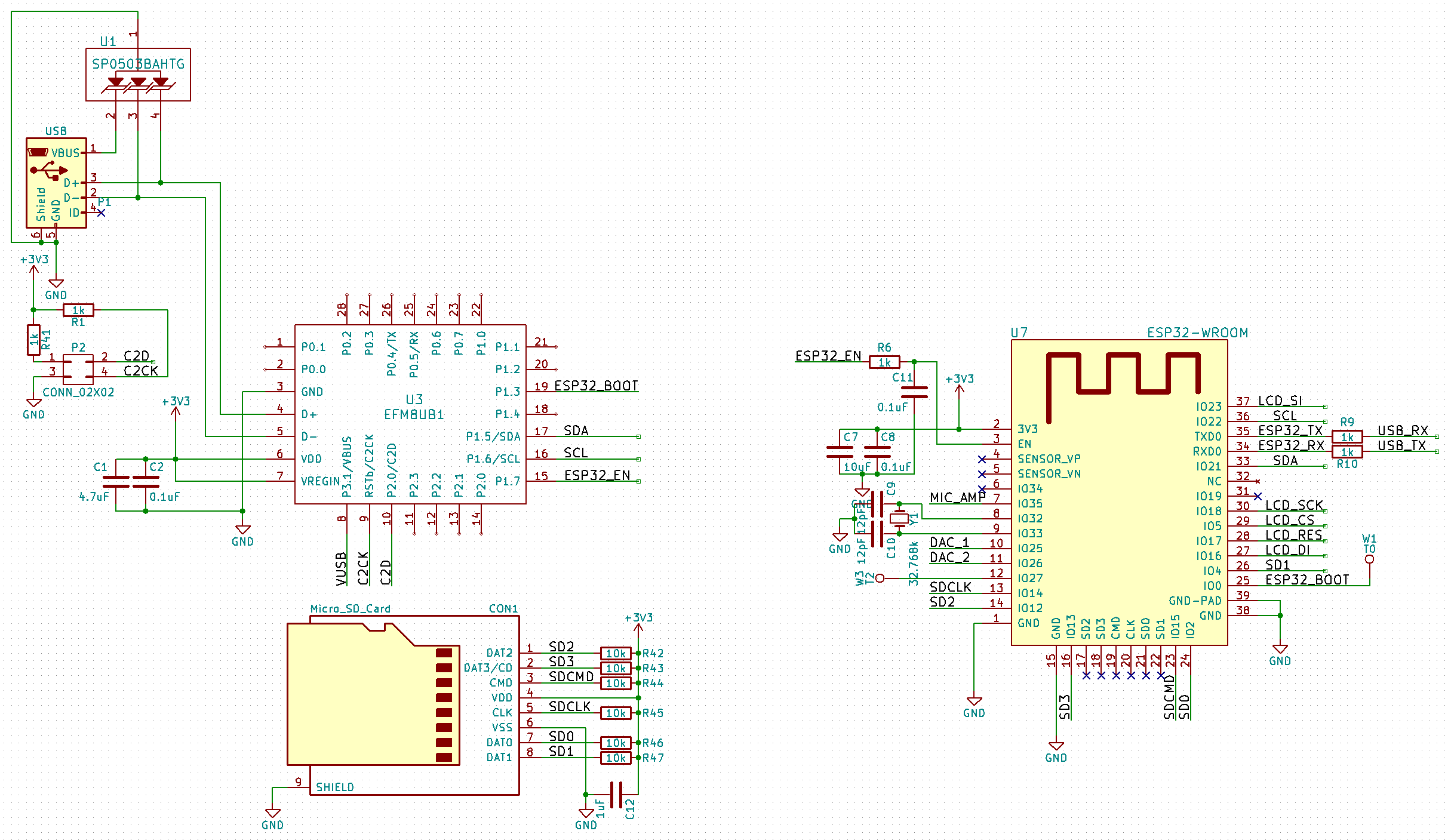

If would post your boards schematic, it may help understand your problem better.
In general, you do need external pullups for SD card (internal ones are not adequate for high speed cards), and your download mode circuit needs to pull GPIO2 low on download (just as it pulls low GPIO0).

I've attached a simplified schematic. What I'm hoping to use:
1. SD card
2. SPI bus for LCD
3. Internal stereo DAC
4. Internal ADC
5. I2C
6. 32.768kHz crystal
7. At least two touch pads
I have fairly limited options for pin assignments. GPIO2 is used by the SD card. GPIO0 is tri-stated by the USB controller if it's not resetting into the bootloader, allowing it to also be used as a touch pad, so I can't simply connect GPIO0 and GPIO2 together as suggested in the SD card example. (Yeah, it's probably not the best idea to share it like that, but it's good enough for hobbyist use.)
It seems like my options are:
1. Remove the pull-up on SD0 and hope for the best.
2. Remove the 32.768kHz crystal and move one touch pad to that, allowing GPIO0 and GPIO2 to be connected.
3. Get the esptool stub to work with the SPI flash when loaded in UART boot mode?
4. Route signals through the GPIO matrix?
5. Something else?

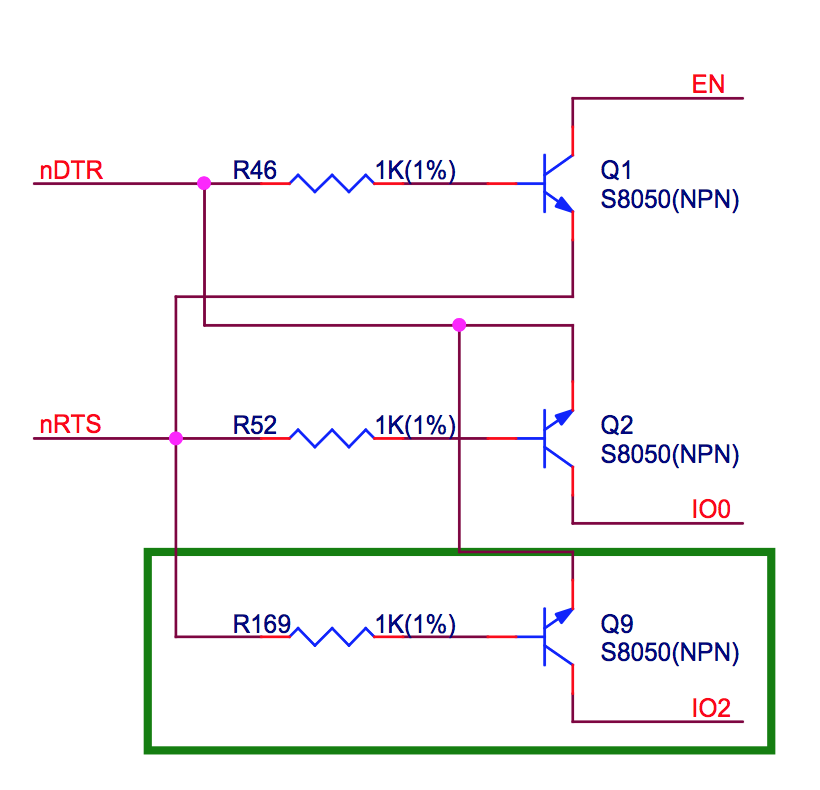

Re: Bootloader woes and SD card pull-ups
Instead of connecting IO2 and IO0, can you drive each of them to low logic level when in download mode? This way both pins will be low (as required by bootloader) but will still be allowed to work independently when not in download mode. Here's a part of the schematic of WROVER-KIT where we have added the third transistor to do that.

Hi guys,
I am bit confused with this, I am not so experienced in the hardware part.

Could you please tell me how it should be connected to be capable of using 4-bit mode and, more important now, to be able of go to download mode, flash and reset without having to disconnect the SD pins every time?
Last thing, adding the Q9, as in the picture form the post above, to the schematic of the ESP32DevBoard would solve this issue or is there anything else needed too.
