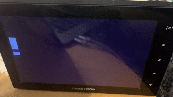

Am running into similar issues with an 800x480 display running the ESP32-S3 LCD peripheral using the RGB dot clock interface.As I said, problems rise when the application code starts using the PSRAM for other purposes, as this seems to "stretch" the GDMA transactions, making the LCD peripheral loose data.
The only way to solve this would be some sort of hardware priority schemes which allow GDMA to complete its job without being interrupted.
When stationary and the processor is doing nothing else, the display looks fine. Whenever I am also doing some other processing (I think it is likely accessing PSRAM) the screen glitches. I have tried pixel clocks between 5 MHz and 30 MHz and the same effect occurs.
I have tried enabling the relax_on_idle, and now I am triggering a screen redraw only when the display data has changed (rather than continuously in “stream” mode). But that had no impact on the glitching.
I agree that some method of controlling priority or temporarily locking PSRAM access might be able to solve this. I’m eager to hear if anyone has suggestions or has successfully overcome this issue.

I spent today evaluating the code. Unfortunately the project I am trying to integrate it into is rather complex (CircuitPython) so it's difficult for me to give specific debugging feedback about these issues.
Here are my observations:
1. This code appears to use all the CPU cycles, so I turned off the interrupt after VSYNC and I manually trigger a refresh.
2. I still get glitches when the screen is redrawn.
3. At > 26 MHz, the vertical sync is really bad. (Perhaps this has something to do with my changes I implemented in #1.) 4. At 20 MHz pixel clock, my bouncing square is visible, but still glitchy. The glitches include a large square with some portion being yellow, and a "ghost" square that suggests the sync is being delayed. 5. I am getting some unpredictable crashes. Unfortunately I haven't been able to capture the debug log.
Note on my code: I am drawing a white 40x40 pixel square that is bouncing around the screen. Please note that these GIF images don't capture the actual speeds, but I hope they give some sense about the glitch behavior.
Screen is 800x480 16-bit parallel using RGB dot clock LCD peripheral with a ESP32-S3 devkit N8R8 running at 240 MHz with Octal SPI PSRAM.

Thanks for the suggestions and for the code. I really appreciate the effort that your team is taking to try and get this to work, this LCD peripheral is a great capability to have.
I tried adjusting the size of the bounce_buffer_size_px and saw some odd behavior depending on the size. Sometimes nothing would display, sometimes the image would have missing rows. Sometimes it would crash very quickly. For example, using bounce_buffer_size_px = 10 * 1000, it would run for about 2 seconds and then restart.
I ended up using 16 * 1000 for the size of bounce_buffer_size_px for the demonstrations above on the 800 x 480 display.
Currently, the CircuitPython port for ESP32-S3 is only using one core. (To me this CircuitPython project is fairly complex to understand and debug, but if you have specific questions I will work to get the answer.)
If I use the code with the interrupts enabled, once the display was initiated, the system would hang. I assumed that this was because the display refresh interrupt kept stealing all the processor cycles. So, I disabled all the code lines that setup the interrupt on VSYNC. To refresh the display I added a "flush_buffer" function to flush the Cache and call lcd_rgb_panel_start_transmission (see images in the previous post).
I just changed my "flush_buffer" to flush the cache and call lcd_rgb_panel_restart_transmission (instead of start_transmission). It is still out of sync, but the weird giant boxes are gone. That's a step forward.
In the lcd_rgb_panel_restart_transmission I added a "esp_rom_delay_us(1);" after the gdma_start, but it had no effect.
Perhaps there is something that is slowing down the transmission after it starts. I'll need to dig in further to understand the bounce code that you added. Any suggestions are welcome.

Re: ESP32-S3 RGB LCD maximum throughput
One more positive update!
Now that using "restart_transmission" was showing some progress, I decided to add back the interrupts (like the original code). For some reason, the code doesn't hang anymore (not sure why this is different from my earlier trials).
Now with a 24 MHz dot clock and a bounce_buffer_size_px = 1000 * 18, this is a very positive step!
I can now demonstrate the bouncing box (white 40x40 pixels). Also, I added four red squares ( red20x20 pixels) in the corners so I could check whether the screen was synced properly.
This is looking very good! I think using "start_transmission" to refresh the screen was causing my issues. There are still some mysteries about why it wasn't working previously. I will do a little more experimenting and will report back if I can understand any more about the "bounce_buffer" and what are the important aspects about it to get it to work.
Many thanks for sharing this code for evaluation!
Nice to see it works! I don't think I use restart_transmission in my testcase and it doesn't really make sense anyway in a situation where you have a continuously-scanned LCD; I'll see if the logic there needs changing or something.
